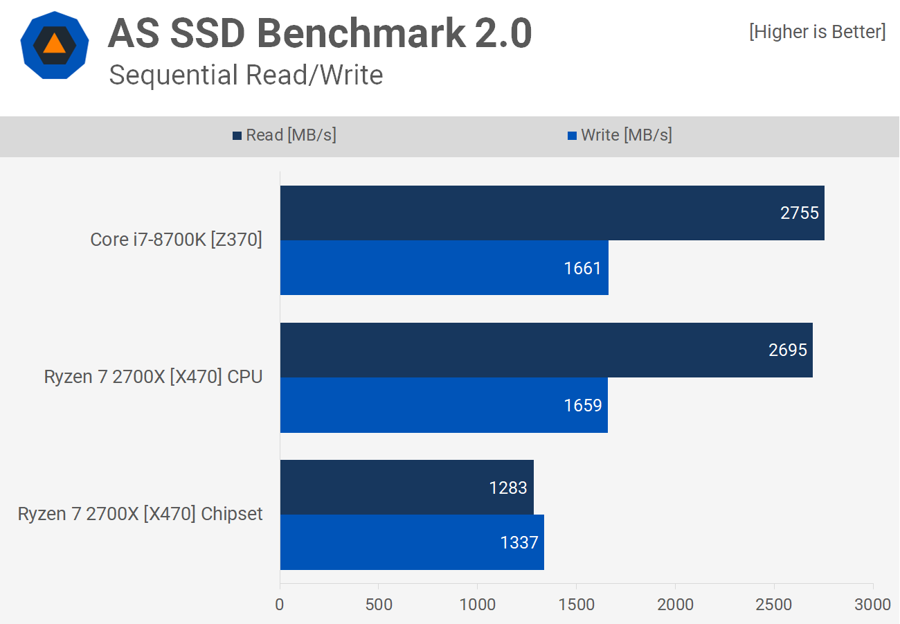

Many, you have one M2.0 drive and then you have a Secondary large SATA/USB 3.0/1 drive for storage. The moment you are going to transfer/copy from one to the other or to a third drive, your primary M2.0 on Intel Z370/390 will have half the speed.
That doesn't add up, copying to a Sata/USB3.0 drive wont saturate half of Intels DMI PCI lanes.
DMI 3.0 has 3.9 GB/s bandwidth. The Maximum SATA Bandwidth is 600 MB/s.
Even a full maximum speed SATA Copy between two devices would not use half the DMI 3.0 bandwidth.
So, no you haven't lost half your Bandwidth.
But now look at a Drive connected to the second NVMe Slot on AMD MBs:
You lose more than half your throughput. Not on some rare, occasional event. But all the time.

But now look at AMD Drive connected to the second NVMe Slot:
That's great, but where is the graph for 2 NVMes connected to the PCH on the Intel platform?
I bet it's no worse than what happens to the NVMe drive in the second slot on AMD X470:
Why don't you bring some evidence to the table for a change, since you implore others to do the same?

I'm not sure if my old mind is playing tricks on me or if I remember right, but I think connecting your m.2 via PCH used to gimp it. And if I got this right, the bigger problem for the average end user was not bandwidth but latency. 4k random read latency on a PCH used to be in SATA territory.
So I asked over at storage review and continuum found this review which is miles better then that techspot review:
https://www.pcper.com/reviews/Storage/Quick-Look-AMD-Ryzen-X470-NVMe-Storage-Performance
Whatever m.2 via PCH used to be, on the z270 it is actually faster then 2600x cpu lanes! At least at every day enduser tasks. The wrong description of the chart aside, 4k random reads at qd1 have quite a lot lower latency on z270. I hope AMD can improve here with zen 2.
That test only concludes that the RAIDXpert driver is causing a bottleneck on the AMD platform. With one NVMe attached to the chipset, you get half the bandwidth, for sure, but the other one connected directly to the CPU still gets full bandwidth. On Intel there isn't a way to connect NVMe directly to the CPU without a PCIe adapter. The PCPer article has the "CPU-connected" NVMe on the Z270 platform using an adapter.

They do speak for themselves and confirm what I stated : In the first case, your simultaneous transfer to the USB cut the speed of the 970 Pro M.2 Nvme Drive because your chipset created a bottleneck as it swamped. In the second case, when you weren't doing the simultaneous transfer, the speeds of the SSD 970 Pro increased roughly by amount of the USB transfer hilariously showing this even further.
Definitive conclusion which was obvious to anyone before the test : Intel's decision to put so much I/O through such a little pipe (DMI 3.0 - PCIE 3.0 x4) was ridiculous especially considering that NVME are first class citizen storage devices that can slam the bandwidth provided by PCIE 3.0 x4. There are a number of use cases where I most definitely don't want my NVME storage hanging off of the chipset where I have a wealth of traffic flowing through.
Practically an insignificant reduction compared to using the Second NVMe slot on AMD's X470 platform.
By doing a simultaneous copy during a full transfer speed test, he reduced speed on Z370 drive to ~2600 MB/s.
Using the Second NVMe slot on AMD X470 speed was reduced to ~1300 MB/s, while it was doing nothing at all.
So Z370 was still twice as fast while doing a simultaneous copy. How terrible for Intel. :rolleyes:
