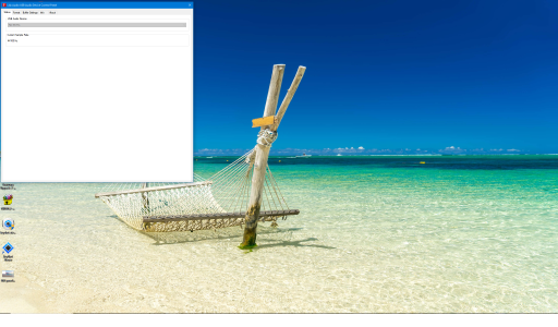

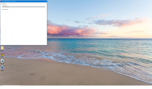

But when I connect the DAC via USB:
My question wasn't so much about "would it sound differently," but rather, does the motherboard process the sound in a different way...or does it all go through the Realtek ALC4080 chip then out to either the audio jacks or USB?
28,173
19,203
It's right there in the pic. "USB audio device". That means onboard audio is bypassed and everything is processed by that audio device. Try disabling the Realtek device in Device Manager.

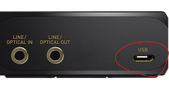

Boomer talk me out of the AE5 on Newegg, it has front audio ports and a slight increase in SNR. The AE9 is too much from Creative store. but there is a AE7 I think with no RGB and a AE5 with and without.
Red circle biggest problem with this device I have.
BoomerD
Feb 26, 2006
66,529
14,911
What is that? Doesn't look like the AD5, AE7, or AE9.

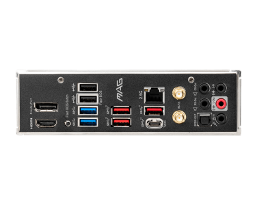

yes, type B at the DAC...Just wanted to verify that the type C would work. I only have one type C on the back of the motherboard, but it's unused. I DO have a type C on the front of my case...I generally just charge my phone with that.
The type A ports are (2) type 3.1 and (3) 3.2, with only (2) 2.0. (one is the flash bios port which I leave open.)
For some reason, the "red" ports don't function when accessing the BIOS, so my keyboard is plugged into the two blue (3.1) ports, mouse into the right-most 2.0 port. I'd like to use the type C port to the FiiO K5 Pro.
tcsenter
Sep 7, 2001
18,949
575
You have USB motherboard headers to add more USB ports. Two USB 2.0 headers (JUSB1 and JUSB2) that could add four more USB 2.0 ports total. And one USB 3.1 (Gen 1 5Gbps) header (JUSB3) to add two USB 3.2/G1 ports. And another USB 3.2/G2 header (JUSB4) which I presume is already used to provide that front panel USB-C port? Since the K5PRO USB port is 2.0, you don't benefit from using the 3.x headers but they are backwards compatible so they would work too. Would you prefer to plug the long USB cable from the front or back? If from the back, you could use something like this:
