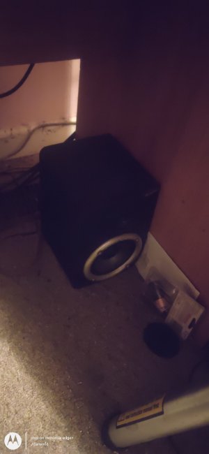

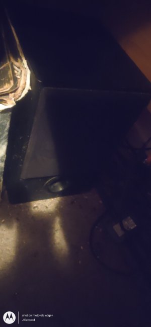

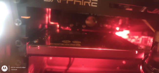

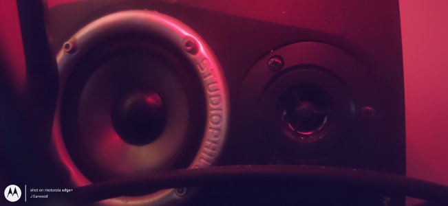

Here's what I use sorry about lighting because my flash works 1/3 the time is lucky.
