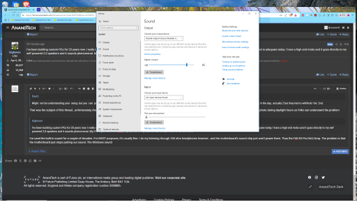

Left click on the speaker in the task bar, then left click the sound output thing at the bottom right, how many outputs are there? When you don't have sound on your headphones, are they still the choice, or is it something else? BTW this is with Windows 11. It's basically the same with Windows 10, but not exactly.
DaaQ
Dec 8, 2018
2,023
1,439
I totally get the need for a soundcard to drive headphones. I don't use them. I don't have to be quiet for anyone. 😁
Yea, my nephew in law? or the younger version of that, was over and I played a video of LM and de lidding and normal setting is 2 for volume. I turned it to 8 for him to experience.
Although I have 5.1 M-Audiio surround setup, (had to get cables from guitar center lol) and he couldn't believe the output.
BoomerD
Feb 26, 2006
66,332
14,740
Shows two outputs, Realtek digital and Dell monitor. (which has no speakers, but does have sound output)
When the glitch…glitches, Windows still sys it’s working…but there’s no sound.
Apparently it’s a fairly common issue with the Realtek ALC4080 chip.
