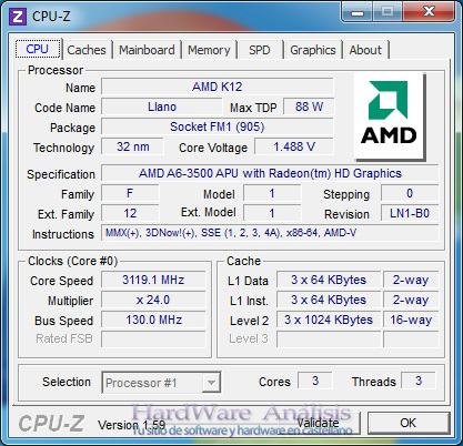

That is a very slow processor. 3 cores at low clock speed. An upgrade to an A8-3870k would get you 25% more clocks and 33% more cores. And you can overclock it at least a little bit. But that's $87. If you can get $40 for your chip then I would order the A8-3870k the same day you ship your A6-3500. That upgrade is definitely worth $47.
SPBHM
Sep 12, 2012
5,076
440
yes but, if he overclocks the 3500 the gain will be smaller,
I think FM1 could work with the "FSB" at higher rates, like 133, and I think he can change the multiplier to the maximum turbo mode for all the cores, so something like 24x133 should be possible (3.2GHz), obviously it would only have 3 cores...
but as you said, $50 for this upgrade is not to bad.
