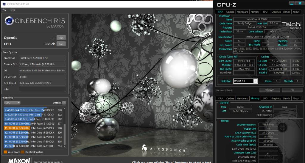

Man, just run cinebench R15 or R20 and share screenshots of cpuz and gpuz with us. There is no way 2500K is anywhere near Ryzen 2700.
I5 2500K gets 568CB @ 4.5Ghz OC, ryzen 2700 gets 1823CB @ 4.1ghz. (This cpu is more than 3x faster than 2500k).
