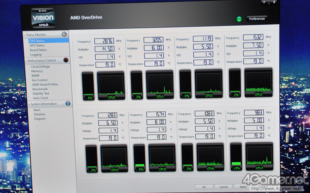

hamsandytheorem
Jun 1, 2011
http://www.4gamer.net/games/100/G010000/20110607029/
(edit...for english, click here: http://www.techpowerup.com/147067/AMD-FX-8-Core-and-4-Core-Processor-Systems-Seen-Running-at-E3.html )
a bunch of new bulldozer slides. I didn't know that each integer core could be clocked independently, so maybe that's interesting :)
screenshot.html
