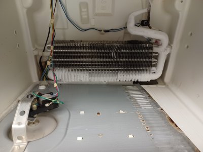

Yeah, the fact that the frost is concentrated on a few components in your photos does NOT tell you whether the cause is low coolant level, nor does it tell you there is a flaw or leak at that particular spot. That is just the location where there is poorest air flow to prevent frost build-up AND poorest heating to melt the frost in the auto-defrost cycle.

The picture of freezer currently, and the fan is blowing strong.

The frost accumulation on only the lowest coils in your recent photo MAY indicate that those coils are much colder than the upper ones. IF that is the case, I would start to suspect low coolant level so that there is not enough coolant evaporating in those coils to chill them all. BUT it also may indicate poor air flow from inadequate fan action if the fan is running too slowly. OR it might indicate that the flow of cool air from the fridge section up into the cooling coil area is very humid, pointing to a leak in the fridge door seal. (The way it works is there IS flow of air from the fridge, through coils, and back down. There is a baffle between the freezer and fridge chambers in the path of air flow down to split the cold air circulation between the two chambers.) You say your paper test does indicate some leakage on that lower door. You MAY be able to adjust the fridge door mounting to get it tighter to the frame and reduce the leak, especially if the leak areas you found are along the hinge edge of the door. For the other possibilities, you might need an experience refrigeration tech to tell you the real cause and cost to fix.
