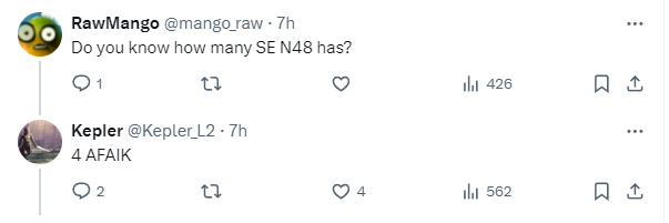

So if it is 4/2SE instead of 2/1, extremely impressive area eff.

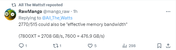

First number is WGP
Second is CU and probably Infinity Cache too
Third is bus width
Fourth is memory bandwidth, 21.7Gbps GDDR6 for N48, 18Gbps GDDR6 for N44, same as N33.
Final number appears to be effective memory bandwidth, basically confirming IC is the same as N32/33 with a clock bump. https://www.amd.com/en/products/graphics/amd-radeon-rx-7800-xt https://www.amd.com/en/products/graphics/amd-radeon-rx-7600-xt
So, is the 515 a typo and it should 2515 instead?
I assume these are base clocks and not boost (or whatever the hell AMD are calling them now) ones.
AMD no longer gives base clocks (or just for RDNA3 as base clocks were weird) Just game (typical median) clocks and boost (typical peak).

240/140mm^2 was my estimate.
First number is WGP
Third is bus width
Yea, the number looks like IC capacity, otherwise it does not really make sense to list that number as 1WGP = 2CU anyway.
2770 MHz sounds slow-ish? I was expecting them to finally meet the 3GHz clk meme (unless there are serious IPC gains compared to RDNA3?)
The last number cannot be clock speeds as AMD has made them non static, plus each SE and the frontend have their own clock domains on RDNA3.
Both numbers line up with effective memory bandwidth.
