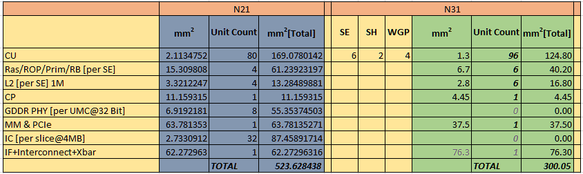

By making a ~402mm2 GCD, It should allow 8 SE, 160 CU, 10240 Shaders, 640 TMU, 256 ROPs while costing ~$130 vs ~$102 for the whole chip including 6 MCDs.
Performance would be a lot better even with reduced clocks to keep power in check, so they could ask a lot more than $999 for this, which would easily cover the higher production cost.
