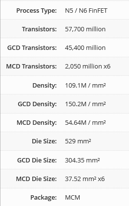

Well, to really benefit from a multi-chip strategy, the GCD's must be modular as well. That will help with scaling across product lines (as I believe @Kepler_L2 was pointing to. Then, AMD will need a very high bandwidth, low latency interconnect like Apple uses in it's dual chip M2 Ultra SoC. Apple, and TSMC have shown that this can be done with two 'chiplets'. This will have to be extended to three or four interconnects with smaller GCDs (maybe 150mm^2) to go from a lower end GPU up to the top performance rung. Sadly, if rumors are correct, AMD will be using N4P for RDNA4 - rather than the higher density N3E; maybe the performance (clocks) just are not going to be there with that widely available node at the start of HVM.
If AMD is using N4P for RDNA4, we may be looking at something very different. RDNA3 appears to be density optimized (according to this, the GCD has a density of > 150M / mm2), which makes it a poor fit for high performance gaming, but great for mobile.
If AMD is able to relax density for RDNA4 and allow for higher clocks, we may actually get a proper flagship out of them.
-That is an outrageously high transistor density if true. RDNA1/2 was something like 50Mtr/mm2 on N7.
AMD was clearly going for as small a die as possible, at the expense of absolutely everything else.
I wonder how many of those extra transistors in N31 are just there compensating for the absurdly high density (ironically).
I have no idea of the accuracy of the numbers, but are you comparing the overall chip of RDNA 1/2 to just the GCD of RDNA3? You would need to compare the density of RDNA 1/2 without all the memory controllers and such which should be much denser than the overall chip.
