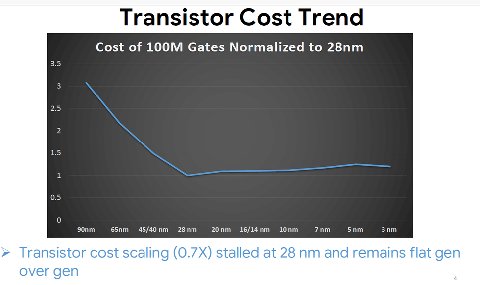

Now they're paying TSMC by transistor count? :)
It's become more useful for comparisons than die size when using different process nodes, as node related transistor cost reductions have stagnated.
So designs with a lot more transistors usually rise in cost.
You pay for wafers not transistors. The fact that N48 is like 2x the transistor density of B580 doesn't change the price.
More advanced Nodes cost more per wafer. That is the reason that transistor price reductions have stagnated. While the graph exaggerates the point, the steep down slope of the past is over.
Zen 5 is many more transistors but same size. Cost per transistor decreased. It's plausible RDNA4 is DTCO cache maxxing in a similar fashion.
But I still think it is 380mm²+.
There are things you can do to pack in more density, to make a bit better use of a node. But there isn't a endless supply of these, so you are still faced with the flattening of the old curve.
380mm²+ is still a big die on an expensive node.
Transistor count is a terrible metric for comparing designs.
First off, transistor counts can vary depending on how they're measured. Unless we know that two dies are measured the same way, the count could be off.
Secondly, chips can have varying levels of transistor density, even on the same node.
An extreme example of this would be Zen5 VS Zen5c. They have the same transistor count, but the die area is way different.
A more applicable example for graphics cards would be how B580 is way less dense than AMD or Nvidia GPUs. The B580 has less than 40% as many transistors as the 9070 XT, but the die is ~70-77% as big.
Transistor count should never be used to compare chips imo. It has too much margin for error.
It's more useful than die size, if they are on different nodes.
If they are on the same node, then you can compare die size.
The problem is when people comparing die size across nodes, which is completely non comparable.
Navi 21 N7 ~27B transistors
Navi 48 N4 ~53B transistors, almost 100% increase
I agree that tracking transistor costs is useful, but using it for die costs estimates of different designs might lead to very weird results. 6900 XT launched for $1000, and it looks like N48 needs even higher price for similar margins. Even if we take 6800XT MSRP as guideline, the math still looks bad.
What about libraries and the varying densities? Die area, wafer cost and defect density, not simply transistor costs.
The best way to compare costs across nodes is to multiply the die area by the cost-per-wafer.
Any comparison with a 50%+ margin for error is useless.
