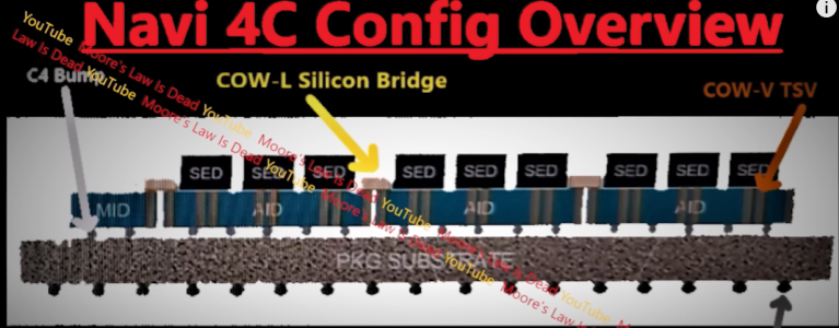

I think they would use a single N6 die with 2 MCDs + Infinity Cache. with die size of 100-150 mm2
Then they would stack GCD of approximately same size (N5, N4, N3) on top of it. Which would be Navi43 (or Navi53). This part should be bordering non-brainer feasible, even in 2024.
The tricky pat would be to connect multiple of these stacked MCD/GCD combos (2, 3, 4) with extremely high bandwidth low latency link that would also have to be stacked and using Hybrid Bond. I have seen active silicon bridges (in AMD patents) spanning 2 dies, but it is unclear if this technology is feasible.
It could look something like this, it could have potentially only a 3 types of dies (or potentially 4 if they added an I/O die. I think that is the only way would approach competing on highest end, competing with 500-800 mm2 NVidia monolithic GPUs.
Seems like I was (mostly) on the money with this diagram.
- GCD (can) become multiple SED (shader engine die). Not sure about the benefit
- my MCD+IC is called AID (active interposer die)
- MID in the picture is what I mentioned as a potential other separate die.
BTW, @DisEnchantment digging up the patents is what lead to my composition above.
Here is what MLID shows as a potential Navi4C.
So, good to keep in mind that AMD is really going for it, it is going cut off NVidia's testicles in client and datacenter GPU the same as it did to Intel in server CPU.
Those are naked shader engines backed by L2.
Oh it's more than that, trust me.
Well yea, current Radeon hweng program lead is the Rome/Milan dude; quite the experience in snapping necks thru the wonderful power of silicon spam.
NV is already twitchy about all manners of DC GPU stuff so they're defo doing the right(tm) thing.
Seems that way. also, a lot of routing of data.
But for the purpose of building blocks and scaling to make different level SKUs, each one of the AIDs will likely connect to 2 memory channels on both ends.
Do you think that AID can stay on N6 or is it going to be a more advanced process?
Hard to fight silicon spam when you are at the reticle limit.
Even harder when the competition can mix in inexpensive N6 into the spam...
N6 is the last good node for SRAM spam so like, lol.
What are the other options?
It's not inexpensive, still like 9.5k a wafer.
Halo N4x cost to build was something horrendous(ly funny).
If there are any parts of the GPU that migrated outside of SED, I was wondering if it's something like N5, but I hope not, I hope it can stay on N6
I thought AMD was paying like 7k for N6/N7 wafers.

nope.
They pay market prices.
BTW, this mysterious tiny COW_L silicon bridge die can open the floodgates of future designs...
I would like to be a fly on the wall, when Intel's Foveros people who go on their typical daily routine of self pleasuring themselves, when Pat Gelsinger storms in the room and screams:
"Is this what you have been doing here for a decade?"

Well yea that's the idea.
big CoWoS is hard, limited capacity and expensive.
Seems like a good incentive to get Mi400 out pronto. To bypass the CoWoS capacity constraints.
BTW, silicon bridge, with HB, should also reduce power overhead and allow higher bandwidth.
