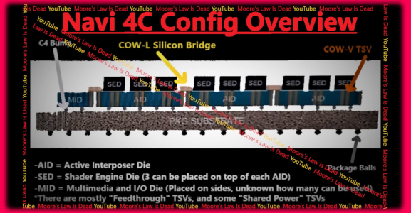

Ehhh they're not that cheap.
Don't be silly.
Just that RDNA4 was capped off with total monstrocities.
This doesn't look like RDNA4 will cost only $399. And what happened to RDNA4 being tiny monolithic chips?
Now It looks like It won't be monolith but chiplet.
adroc_thurston
Jul 2, 2023
8,264
11,019
So they just get their engineers working on stuff without looking at all possible angles?
But RDNA5 is going higher than canceled N41 or just same?
how would I know.
after having proved it in R&D first
what the hell is MI300 even.
That's probably what NV is doing.
No they just have no capability to do what AMD does.
Advanced packaging experts and insanio uncore designers don't grow on trees.
There's a good reason AMD is the sole driver of TSMC's advanced packaging roadmap.
