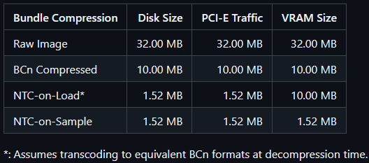

"On-load" is a fallback mechanism for platforms which can't execute "on-sample" fast enough. But you still use NTC in your game and engine.
On-feedback​
On-load is a last resort for platforms with lack of sampler feedback. that means Pre-Turing cards, Pre-RDNA 2 and PS5. All newer cards can use the "on feedback" mode to get "Much lower VRAM usage compared to fully mapped textures". No inference overhead at all.
Here's the GDC 2025 link again:
On feedback is the real fallback option, not on-load, and it'll work on anything from the Switch 2, RTX 2050 mobile, 1650, and RX 6600 to 9070 XT, 5090, and the B580.
From the NTC Github page.
Variables for on-feedback math
If we take NVIDIA at their word NTC is ~6.6X vs BCn. Figure from ^ and the Compusemble vid and for a multi-layered PBR material.
For SFS IIRC Microsoft claimed 2.5X VRAM multiplier. Let's use that for On sample as well.
For texture portion of VRAM let's say 50-70%.
On feedback math:
Let's start at 8 GB
50 to 70% textures gives us 4 to 5.6 GB texture data
Sampler feedback
2.5X VRAM multiplier = 2.5X fewer BCn textures.
4 to 5.6 GB / 2.5X = 1.6 to 2.24 GB BCn textures
and
2.4 to 3.36 GB NTC textures
NTC impact
Applying 6.6X to NTC textures
2.4 - 3.36GB / 6.6 = 0.36 to 0.51
Subtracting from NTC total
2.4 GB - 0.36 GB = 2.04 GB saved
3.36 GB - 0.51 GB = 2.85 GB saved
Savings in percent
2.04 GB / 8 GB x 100 = 25.5% saved
2.85 GB / 8 GB x 100 = 35.6% saved
^Result: ~25.5 to 35.6% lower total VRAM usage or effective 1.34 to 1.55X VRAM multiplier.
Now 5 to 6 GB cards functions as 8 GB or 8 GB = 10.72 to 12.4 GB.
On-sample math
For on-sample we can calculate the NTC saving on the entire 4 to 5.6 GB texture VRAM allocation BCn.
4 GB / 6.6 = 0.61 GB
5.6 GB / 6.6 = 0.85 GB
This is 0.61 to 0.85 GB textures with NTC
Subtracting from BCn
4 GB - 0.61 GB = 3.39 GB
5.6 GB - 0.85 GB = 4.75 GB
Savings in percent
3.39 GB / 8 GB x 100 = 42.4% saved
4.75 GB / 8 GB x 100 = 59.4% saved
^Result: ~42.4 to 59.4% lower total VRAM usage or effective 1.74 to 2.46X VRAM multiplier.
Now 3 to 5 GB cards functions as 8 GB or 8 GB = 13.92 to 19.68 GB
Implications and conclusion
I know this is just a guesstimate but it's still fun to guess and this was an eye opener. NTC is going to be a big deal even during the PS5/PS6 crossgen era. Other IHVs will have their own SDKs.
With "on-feedback" gamers can enjoy some of the benefits of "on sample" without the downsides. Since PS5 is baseline during crossgen I expect future games that leverage NTC to benefit 8GB and 12GB cards greatly.
Inference on sample is really meant for the post-crossgen era and permitting 8-12GB cards to use very VRAM demanding settings. On powerful cards it makes no sense as these usually have plenty of VRAM and even if they don't (5070) on-feedback should be enough in most cases.

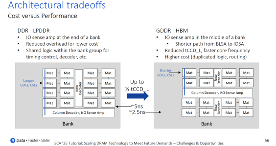

GDDR has to take PHYDES liberties that lower throughput per pin memories like DDR or LPDDR don't have to. The extremely high clock rates also mean your circuitry to drive those signals will have to be larger, reducing your array efficiency (how much of your die space is taken up by cells vs logic and misc parts).

And that won't lead to entire new class of stutterfests?
All this neutral texture compression crap is a very slippery slope, it's bad enough already with upscaling which at least can be turned off or kept at "quality" level on high end PCs.
They'll just add x10 more cosmetics for micro-transactions and it will be back up to 200 GB in no time. Plus games are pretty expensive these days, so paying $80 and downloading whopping 200 GB makes it feel reassuringly expensive, and if it's 50 GB then it's what: small game = rip off?
Unlikely and I would prefer NTC compression over the crappy blocky artifacts BCn produces.
NTC is not DLSS. Deterministic. Think of it as a ML based data encoder/decoder.
In a world where Sony reduces the PS5 Slim to 825GB I'll take any GB saving I can get.

On feedback has no ML inference. All they have to do is use sampler feedback to selectively transcode only some of the NTC textures. The overhead vs on-load could be smaller due to less NTC -> BCn transcoding.

Edit: As prev mentioned prev here's the answers from the NTC dev:
Q1: The NTC v.0.8.0 optimizations from 2 latent arrays to a single BGRA4 texture array are not leveraged in this demo sample right?
A1: The video doesn't explicitly state which version was used, but I assume it was the latest - 0.8.0. In that case, yes, the BGRA4 latent textures are used here.
- NOTE: v.0.8.0 was confirmed by Compusemble
Q2: Do you have any rough numbers to how big the performance gains are for NTC on load and NTC on sample vs v.0.7.2?
A2: The perf gains are 10-20% for On Load, 20-50%+ for On Sample, depending on the GPU
Q3: I've seen people claim NTC on load has a higher VRAM footprint than BCn. I assume this isn't true but can you please confirm?
A3: NTC on load temporarily requires more memory: while the transcoding is done, we need to store the NTC data, the raw color data, and the BC versions of textures. After that, everything except BC can be freed or reused.
Q4: Do you use the latest version of RTXTF that includes CTF in the demo in the video? The technique is from the Collaborative Texture Filtering 2025 paper by Wronsky et al.
A4: No, CTF is not integrated here yet.
Will be interested in seeing what CTF can do about the ugly filtering and an actual NTC game implementation, but prob not happening anytime soon.
