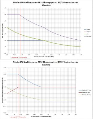

The thing with vector performance is also, that you never reach that if you have INT instructions intermixed. From Turing presentations, about 30% of all vector instructions are INT (gaming). So double FP-Vector FLOPS will yield in ~1.4x gaming performance. Pretty much what we are seeing with Turing -> Ampere. Some compute applications did show 2x speedup. So these seem to be solely FP based calculations.
"True doubling" in gaming could only be achieved if you add a dedicated third INT (only) pipeline, which could run in parallel with the two FP pipelines. If 3 pipelines are inappropriate regarding HW design and scheduling, 1x INT and 3x FP could be an alternative. Maybe 1x INT, 1x INT/FP, 2x FP to maximize utilization in corner cases. With latter configuration it could roughly look like this:
- 1.5x throughput in FP only scenarios
- ~2x throughput in mixed FP/INT scenarios (gaming)
- 1x throughput in INT only scenarios (Blackwell) or 2x compared to Ampere
A pretty decent uplift compared to Blackwell, considering that you only added 1x FP Unit and two additional pipes.
A long time ago, long before Blackwell release, I speculated Blackwell could introduce additional FP/INT pipes. But that version has never seen the light of day, Blackwell just added INT capability to the FP only pipe. The result would look like following (resembling the numbers listed above regarding FP throughput) but "Blackwell" in the graph below is not Blackwell but maybe some future iteration of Nvidias SMs:
- Full FP throughput can be sustained up to ~30% INT/FP ratio, Ampere etc. fall below 75%
- Even at 50% ratio, 67% of the FP througput could be maintained. Ampere/Lovelace/Blackwell drop to 50% FP throughput.

I think you are both massively overestimating what compute can do for you. For a true doubling, they don't need to just add another int pipeline, they'd need to double all the memory access related resources. At which point the units would be twice the size and there would be no point.
The relative cost of moving data to the units compared to the actual compute grows every silicon generation. The point of dual issue is that the cost of everything but the compute has gotten so high that it's worth it to have twice the compute, even if half of it is mostly idle, just to make sure that this everything else is 100% utilized every cycle.

I know what you are referring to. FLOPS are cheap. And for sure, many of not most memory related structures would be required to be updated.
I am not saying, that this will ever be implemented. But ~2x typical gaming performance at less than 2x HW effort (even if you have to double memory, scheduling etc. stuff) doesn't seem so unreasonable.
Amperes doubled FP32 were cheap and yielded nice benefits. So this was a very decent update to the SM with limited cost. But I definitely see a future, where SMs will get wider as scaling is potentially better than just more SMs.
That seemed to have made no difference in terms of gaming IPC
"NVIDIA's Blackwell architecture delivered an average IPC advantage of just 1% over the older Ada Lovelace."
Perhaps Blackwell is just very broken for gaming, maybe they fix this in 6000 series.
basix
Oct 4, 2024
291
594
INT throughput does obviously not limit gaming performance, if you look at the average INT/FP instruction mix. So additional INT TOPS won't help you.
