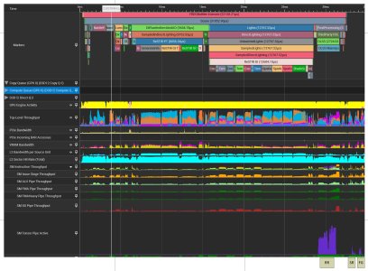

NVIDIA does Ray denoising with FP8 though
I am pretty convinced, that FP4 or FP6 will be utilized wherever possible (advancements in model research, weight pruning, etc.). This allows for multiple things:
  • Reduced memory and bandwidth usage per weight
  • More weights = Enhanced model = Enhanced quality
  • More FLOPS = Faster execution
But you could probably not switch to FP4 for everything, just because Blackwell was released. With that you wouldn't make your user base happy. Some sort this happened with Ray Reconstruction on Turing and Ampere (DLSS4). It still runs, but with FP16 and much slower than the CNN version of RR.
Anyways, for future iterations the next logical step would be FP4 for Nvidia (Blackwell and Blackwell Next support it with more FLOPS) and FP4/FP6 for AMD (RDNA5). DLSS4 Super Resolution still runs on FP16, but I suspect they left it like that because it is rather light on the Tensor Cores (I traced that by myself) and due to DLSS4 SR compatiblity back to Turing. About Frame Generation I am not certain, could be FP8 (because only supported on Ada and Blackwell). But the Tensor Core load is minimal as well.
  • Note: SR and FG use regular Vector/FP32 math and this for the vast majority of their execution times (roughly 80...90% of it).
The only thing which really eats frametime on the Tensor Cores is Ray Reconstruction. See my Nsight trace below (Zorah NVRTX sample, look at the bottom at "SM Tensor Pipe Active").
  • RR takes a significant chunk of the frametime
  • SR is tiny (also with RR there is an additional tensor core pass there)
  • FG is tiny
