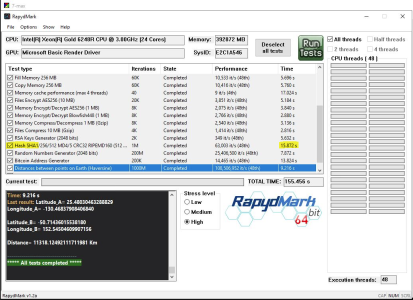

My company's dual socket Ivy Bridge-E beat Comet Lake in total time, only due to more cores. Should be fun to see how 5950X and i9-12900K fare in this benchmark. My guess is that 5950X will win.

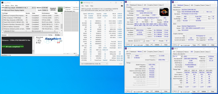

So after letting the platform mature for a bit, i decided to give this benchmark a go again :)
9950X ES
8200 MT/s
2200mhz FCLK
Regular PBO run = 99.308s

After rerunning the tests a few times = 97.690s

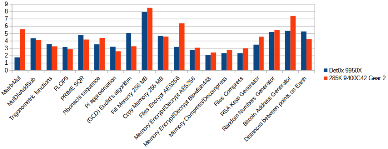

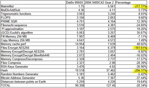

Now we just need some Arrow Lake results to see how it stacks up :)

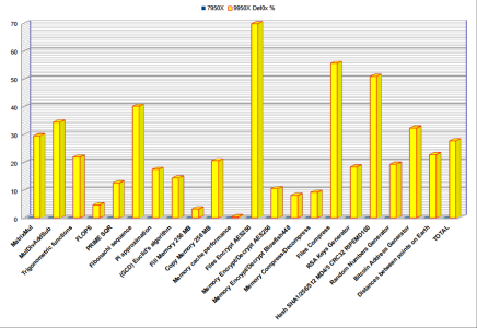

That's a stock 7950X (DDR5-6000 or 6400) with a time of 137 secs and the chart shows % improvement of Det0x's 9950X.
Tests report generated by RapydMark v1.2a (64 bits) https://www.frikiscape.com/rapydmark/

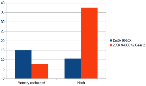

And below you can see the % performance impact of AMD's latest AGESA (Det0x 9950X):
28,173
19,208
Lower is better in both graphs.
Split them because the two tests were messing up the whole graph.
285K settings: P56 E51 R42 NGU 35 D2D 34 (custom cooling)
Reactions: lightmanek

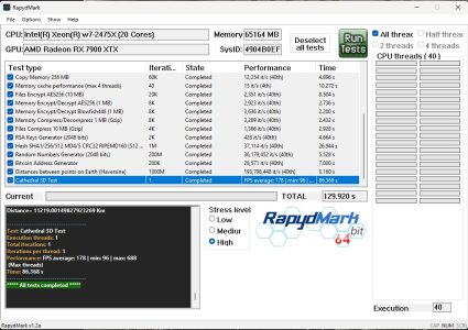

Your 64 core does not beat that ??
Unfortunately, no. It spends over 50 seconds in the Hash test which kills the score (I remember it was ~230 secs). It's due to the eight CCDs. The Hash test needs very low inter-core latency. I think a 16 core Zen5c with single CCD would be a champ in the Hash test. Or maybe Panther Lake with 8P+8E (if they don't manage to mess up again).
9700G, whenever that is released, has the potential to be a champ with 8200 MT/s RAM.
Reactions: Tlh97 and Makaveli

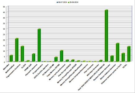

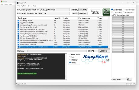

28,173
19,208
Is it normal in this benchmark to have this much variation ??
View attachment 115824View attachment 115825
Yeah, +/- 5 secs is normal. You can almost make it consistent if you run it through 7-Max. Also, you don't need the last Cathedral test. Doesn't affect the time.
Your Hash SHA test score of 27 secs is pretty good for 40 threads. I can get about 26 secs if I run it with just one P-core and all E-cores enabled. But then the other tests suffer due to lack of threads.

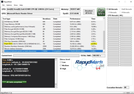

28,173
19,208
Something VERY interesting:
Ice Lake Xeon having trouble with the Hash test too.
BUT
Crazy max performance unlocked with 7-Max !!!
:D
Roughly 17% improvement in calculation time.
@Micrornd , please try 7-Max too.

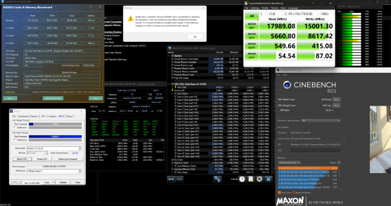

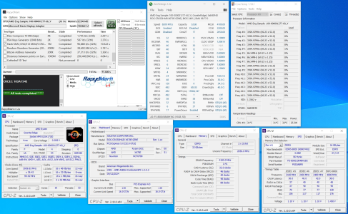

Micrornd
Mar 2, 2013
1,394
252
Terrible, but at least they return to normal when not running 7-Max
But I think I know why.
My theory is that my C:\ drive is "unusual" and 7-Max is written to perform with drives connected to SATA or NVMe on board controllers.
My C:\ drive is a RAID10, consisting of 4 x 1tb Crucial T705s running on VROC.
VROC (Virtual Raid On Cpu), in this case, is each of the T705 NVMEs connected by 4 - PCIe5 lanes each, so 16 PCIe5 lanes total connect the NVMes directly to the CPU, with nothing in between or after.
So rather than helping, 7-Max just adds another "layer" into the control scheme, slowing things down.
This rig is new and I've just finished "gross" tuning so the below benchmarks may improve just a little in the "fine" tuning stage, but I don't expect anything earth shaking.
Please note these BMs are with Hypervisor/virtual "on", 6000 ECC memory overclocked to 6400, a small .199v increase in VccIn, and a base clock of 102Mhz (neither CPU-Z or HWINFO reports the base clock correctly for this Asrock W790 WS board, they always show 100 whether the base clock is over OR under that.
Air cooled and 100% stable.
lightmanek
Feb 19, 2017
519
1,275
Yes, this benchmark likes very fast NVME for best results, as few tests are read/write limited on modern CPU's.
