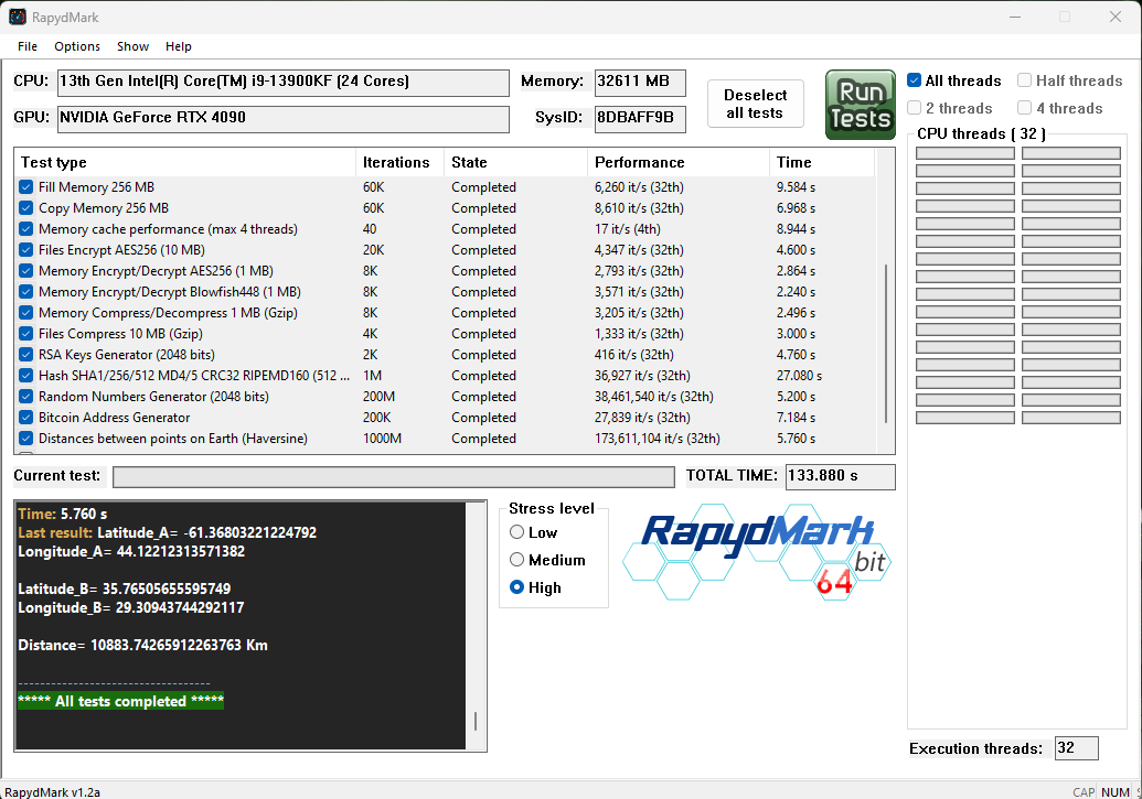

Here is my run with underclocked 13900KF at 5.2ghz on P cores and 4.3ghz on E cores with DDR5 7600 CL36 memory. I think something is wrong with the matrix multiplication test as it's much slower on ADL and RPL than it is on Zen, even though my CPU is underclocked.
Memory frequency doesn't seem to make much of a difference at all.
There is a lot of run to run variance on a few of the benchmarks which is a bummer. Fast and tight memory seemed to scale well on the 5800X3D since my XMP 3600 kit got wrecked by Det0x’s kit. Pretty cool that you are seeing different results with 7600.
Det0x is really good at tuning memory sub timings, but for matrix multiplication, that should be influenced primarily by the core microarchitecture and cache of the CPU I would think.
I can’t get your picture to load for me, but it could be on my end.
Weird, I checked on my phone and the picture was viewable. The score was 133.8s.
