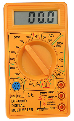

Aha, cmos settings of your mother board.
How old is the motherboard ?
Is it possible that the coin battery is drained ?
A low voltage can cause weird effects because the cmos settings of the MB get corrupted over time.
The coin battery should be ~3V.
May 11, 2008
23,331
1,575
u think if i replace the battery it will work?
Sent from my One using Tapatalk
I do not know. Measuring if it is full or empty will give certainty.
However, if you have exactly the same coin battery but new. You could try it.
If you replace it with the new one, just to be certain is always good.
Replace it only with the mains plug disconnected.
And after replacing the battery, clear your cmos first. Then set the jumper to the normal position and see if the computer will post with the R9 270X.
