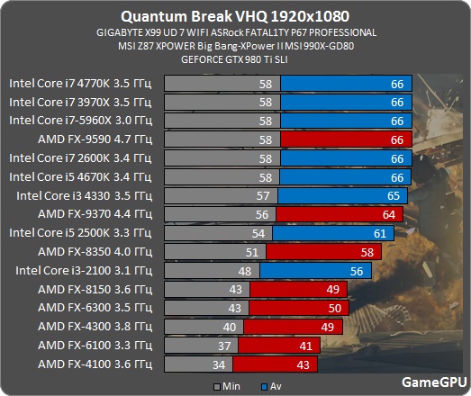

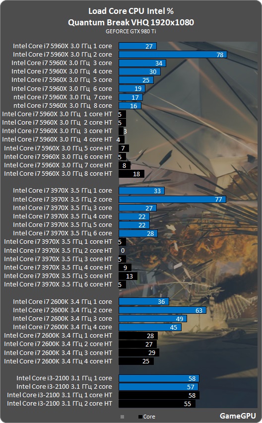

Because they make GPUs for PCs that are actually capable of running games and have no need of the GPU to run the whole game.
Look at that even the i3-2100 hits 56FPS avg and that's with sli which is degrading performance.
And not only that but the ancient dual core only runs at 60% usage.
