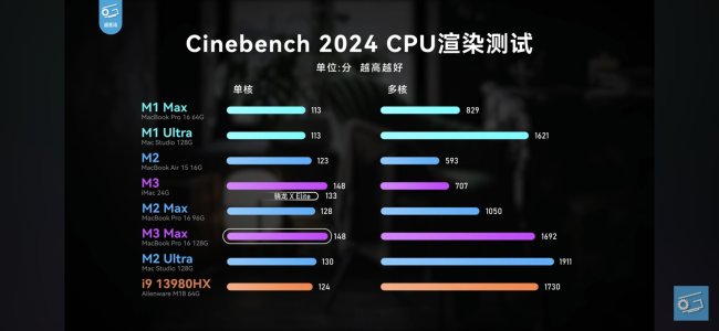

M3 is more than 10% faster (148 vs 133) than X Elite in Cinebench 2024 ST, a gap that is larger than the one in Geekbench 6 (3200 vs 3000).
Seems like CB2024 really likes the extra cache in the M3.

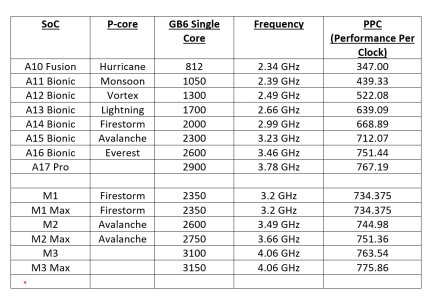

A12 -> A13 is a substantial 22% PPC increase. You can see the that in the preceding years too they have got huge uplifts. It's only with the A14 and after, that the PPC gains slowed down drastically.
____
You seem to be skeptical that Nuvia engineers can't pull off a 40-50% IPC increase in the span of 2 years. (If X Elite G2 with Pegasus core is announced in 2025Q4, that's 2 years after the announcement of X Elite with Phoenix core in 2023Q4).
I believe otherwise. I think Nuvia can do the iimpossible. As Gerard Williams stated, they are not breaking physics, but they are bending it.
No way, in case you forgotten about the table I created to calculate PPC which include X Elite here. Phoenix core has about 700 PPC. If improvement over 40%, that's mean PPC would be 980. Do you really think Nuvia team able to leapfrog Cortex-X5 so much which already shown pretty impressive results.
Based on my estimate, if Pegasus core manage to show 20% PPC improvement, ie. 840, then should be pretty good already.
