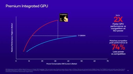

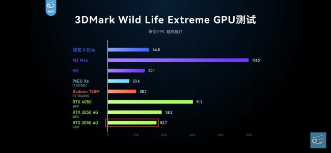

3DMARK WLE
8 Gen 2:
22 FPS @7.1W
X Elite: 44 FPS @31W
So X Elite has exactly double the GPU.
performance of the 8 Gen 2. This fits with the rumour that X Elite has the same GPU architecture as 8 Gen 2, but scaled up by 2x.
That makes sense looking at the performance, but not at the power consumption.
If X Elite GPU is 2x the ALUs of the 8 Gen 2 GPU, then why is it consuming 4x the power?
Yes, the 8 Gen 2 and X Elite power consumption figures are coming from different sources (Geekerwan vs Qualcomm), but that does not explain the huge disparity.
So I see two potential explanations:
1) X Elite is not the 8 Gen 2 GPU, with double the ALU count. After all, this only a rumour. May be it is the 8 Gen 2 GPU, but with 2x the clock speed? That explains the 4x increase in power consumption, despite only 2x increase in performance. I have explained this hypothesis several times in this thread discussion
or.....
2)
That assumes all ALU's are created equal - Exynos is using AMD RDNAx based µArch so it's likely got all the bells and whistles of a full PC GPU in feature set similarly to the Switch GPU albeit far more recent.
This.
Perhaps the 8 Gen 2 GPU does not have the PC-class "features'. So they added these to the X Elite GPU, while also doubling (2x) the ALU count, which may explain the 4x jump in power consumption...

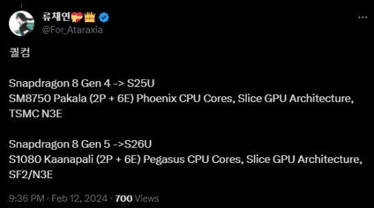

New Snapdragon leak just dropped!
That 8G5 uses same N3E as 8G4 is bizarre. May be a typo. It should be N3P, right.
Also this confirms previous rumour that 2nd gen Oryon/Nuvia core is named Pegasus.
