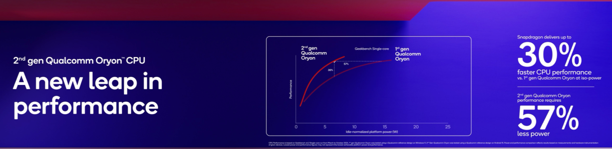

The genius is that they're MORE efficient at those clocks!! Nothing wrong w/ hitting 5Ghz as long as you're ultimately more efficient...
I give them props. Second gen Oryon is a big improvement clearly, and that is without version 9.2 like I mentioned. I think third gen Oryon will see some gains just from that upgrade (for example SME). Maybe they can do a bit of both, increase frequency but also needing to bump IPC.

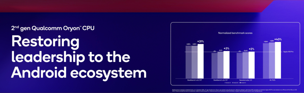

Can’t deny the improvement:

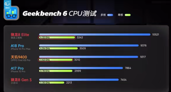

Their next slide is a bit misleading though, particularly with geekbench single threaded and even really multi thread scores. Particularly when you consider the Geekerwan results.
Nonetheless I’ve always been a fan of competition. This will push everyone to improve.
Edit to show Geekerwans peak ST/MT results:
I will note the median A18P MT score is around 8500-8600, so that’s for sure a golden sample (probably freezer too like the 9400 level scores), that ST is right on though.

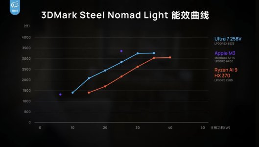

M3 : 3400 points @ 25W
LNL (Arc 140V) : 3300 points @ 35W
STX (Radeon 890M) : 3100 points @ 40W
8 Elite (Adreno 830) : 2600 points @ 11W
Now imagine if Qualcomm took the Adreno 830, doubled it's size, and slapped it into the X Elite Gen 2.
X Elite Gen 2 : 5200 points @ 22W (theoretical)
That will smash Intel/AMD's laptops iGPUs and be a bit better than Apple M5 even.
Qualcomm should go ahead and put a decently big iGPU into X Elite Gen 2, instead of skimping on the die area.

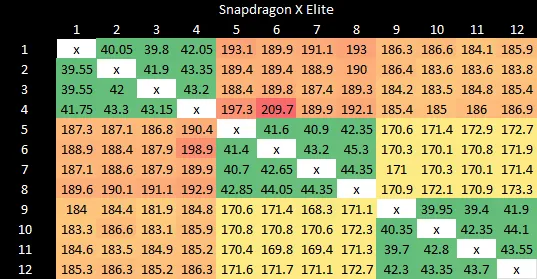

X Elite for comparison;

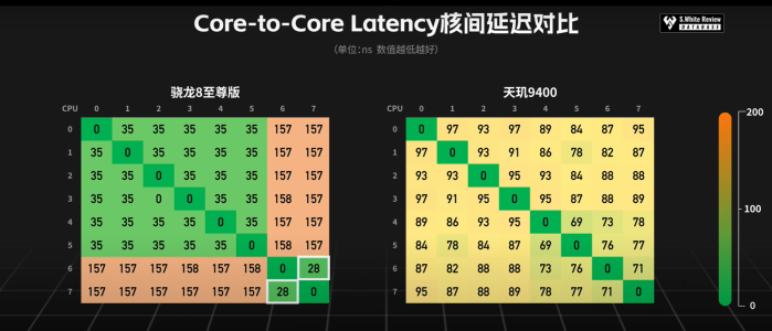

The Oryon CPU in 8 Elite is much better than the one in X Elite.
• Vastly better ST and MT efficiency
• Lower c2c latencies
• Presence of 'E-cores
• Stable 4.3 GHz clock speed
I think calling it 2nd gen Oryon CPU is highly justified.
Apparently another reviewer (S white database) got single core efficiency in Geekbench:
Don't know how trustable it is, but it wouldn't surprise me at all. While Qualcomm leads in MT both in performance and efficiency, there is a discrepancy in core counts and performance of "small" cores, so it will be more efficieny by having more cores and downclocking. Like to like 1 core comparison and Apple core is more efficient and powerful. There is a huge difference in mm2 area in the same node, however, so it's not a bad result at all.
