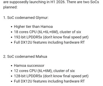

Oryon V2 is rumoured to hit 5 GHz. Do you think it can be dine without adding more pipeline stages?
Also Apple M5 will be around 5 GHz too, I think (M1 = 3.2, M2 = 3.5, M3 = 4.05, M4 = 4.5).
and then Qualcomm needs to make a low power design which next gen X Elite isn’t going be.
Mahua (X2 Elite?) is 6L + 6M CPU. Is that not low power?
I don’t it will be Qualcomm who Intel should be worried about although that 5GHz core if it that happens and its efficient then it’s different.
I do think 5 GHz is probable for Snapdragon X2, though I find it unbelievable that 8 Gen 5 will also hit 5 GHz.
The question is can they do it without blowing up the power consumption to the moon, regressing cache latencies, etc...
PS:
NodePeak
Clock
ST power
X EliteN4P4.32 GHz18 W
8 Gen 4N3E4.3 GHz???
It will be very interesting to see how power 8G4 consumes for ST.
It will show what degree of improvements Qualcomm has made 1 year later to Oryon, and confirm/deny theories that there is some kind of defect/bug in X Elite silicon that's causing the high power consumption.
There is a rumored automotive SoC (SA8797) with 18 CPU cores that shares the rumored core count of the Glymur SoC with up to 800 GB/s memory bandwidth (16x 16-bit LPDDR controllers), 320 TOP/s of inference performance and 8.1 TFLOP/s GPU performance (even 1.4 TOP/s of INT8 on audio), it's possible that the PC oriented Glymur is based on this SoC with a different memory config. to spread NRE costs. (Not sure they can stretch their legs budget-wise at Q as much Apple did with separate designs for A18/A18 Pro rather than die harvesting...)
There is also a rumored BIG automotive SoC (SA8799) with 32 CPU cores alluded to in the links above, which would be very interesting if repurposed as a desktop PC SoC. (Presumably auto SoCs for both infotainment, gauge clusters, and ADAS will require a GPU and the specs of other blocks will scale as well. Adreno 8 is rumored to have a slice architecture after all...)
Reactions: FlameTail

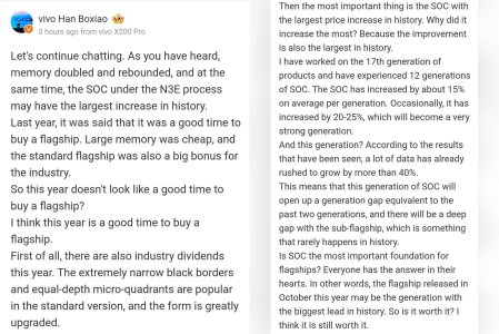

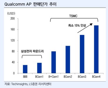

TSMC really is expensive. But also speaks about how QCOM has been increasing die size gen over gen.
It’s not just TSMC. No one can make cheap chips in $100B + foundries using EUV machines. Cost reduction as a part of node advances ended at about the 22 nm - 14 nm timeframe. Since the (virtual) 7 nm node, the costs are astronomical.
How people think budget laptops will stay below $700 and budget phones will stay below $400 is beyond me. A 2 nm laptop launching below $700 will require the involvement of nonprofits.

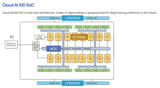

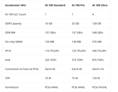

There a rumored automotive SoC (SA8797) with 18 CPU cores that shares the rumored core count of the Glymur SoC with up to 800 GB/s memory bandwidth (16x 16-bit LPDDR controllers), 320 TOP/s of inference performance and 8.1 TFLOP/s GPU performance (even 1.4 TOP/s of INT8 on audio), it's possible that the PC oriented Glymur is based on this SoC with a different memory config.
That sounds beastly. I didn't know that automotive SoCs had to be so powerful. One question though; 16 × 16 is a 256 bits... How do you get 800 GB/s with a 256 bit LPDDR controller? It's impossible even with the latest LPDDR5X-10667 standard.
Raqia
Nov 19, 2008
125
90
101
You're right, that detail sounds incorrect. It's more likely a 16 x (4 x 16) bit interface. Q already has products that likely have this memory controller config. in their latest AI 100 Ultra:
Details are lacking on the specific memory channel config. for that SKU but given the 4x memory capacity and 4x bandwidth vs. the AI 100 Pro:
It's likely they are using a 16 x 64 bit (each a stack of 4 x 16 bit or 2 x 32 bit channels per package?) config. for the AI 100 Ultra. I think it's not out of the question that the automotive part will be able to hit 800 GB/s on LPDDR5X.
