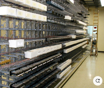

I've done some work on POTS at our CO, mostly cross connection customers to the DMS and/or DSLAMs on the MDF, which looks like this:
