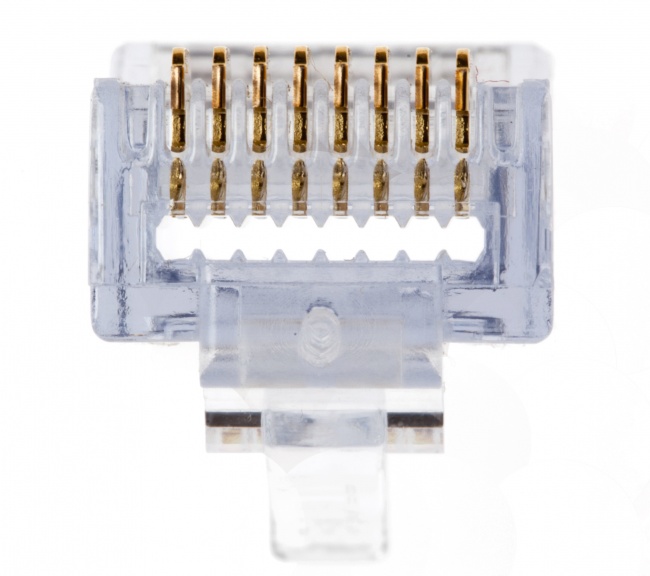

They now make pass through type CAT 6 RJ45 Connector Plugs ... makes it very easy to be sure all the wires are in the correct layout and fully inserted to where they get crimped.
https://www.platinumtools.com/products/connectors/ez-rj45-cat6-connectors-100010c/
