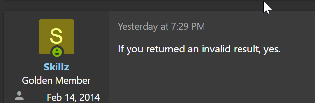

Errors from the client would not make the score go down as the server would never see them as possible valid work. The 35k would need to be something completed as OK (Potential points during the competition) by the client but checked as No Good (Score reduced) by the server or comparing between main/check tasks. An Invalid so those CPU tasks.
Skillz
Feb 14, 2014
1,228
1,239
That's what I said.
