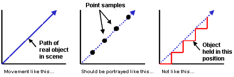

Ever since LCD pixels finished pixel transitions in less than one frame (e.g. 2ms LCD), that's barely more than 10% of the time of a 60Hz frame (16.7ms). LCD pixel response time is no longer the major factor of motion blur.
Most motion blur on a modern LCD is caused by the sample-and-hold effect. Even instant pixel response has lots of motion blur (see Why Do Some OLED's Have Motion Blur?). You will notice PS Vita and Samsung Galaxy S3 has lots of motion blur during scrolling! Their pixel response is virtually instant. The motion blur is caused by sample-and-hold, not by the pixel transition time.
Motion blur is actually more dictated by the length of time a frame is displayed on-screen. Your eyes are always tracking. Your eyes are not in the same position at the beginning of a refresh as at the end of a refresh. As your eyes track across static frames on a display, the frames are blurred across your eyes (by your eye tracking motion). The only way to reduce motion blur is to shorten the static frames -- either by adding more Hz (extra frames, e.g. 120Hz), or by black periods between Hz (black frame insertion, CRT flicker, LightBoost flicker, scanning backlight, etc).
(Source: Microsoft Research)
Vertical axis represents position of motion. Horizontal axis represent time.
Middle image represents flicker displays, including CRT and LightBoost.
Right image represents sample-and-hold displays, including most LCD and OLED.
It is now possible to bypass LCD pixel transitions with various strobe backlights (e.g. LightBoost) and scanning backlights (found in high end Panasonic, Sony, Samsung HDTV's). The backlight is turned off while waiting for pixel transitions (unseen by human eyes), and the backlight is strobed only on fully-refreshed LCD frames (seen by human eyes). The strobes can be shorter than pixel transitions, breaking the pixel transition speed barrier! In addition, it eliminates the sample-and-hold effect.
So again, LCD panel pixel response time is no longer the chief determinator of motion blur on modern displays.

Actually, the LCD panel pixel response time isn't the cause of motion blur anymore. See high speed video proof.
Most motion blur on a modern LCD is caused by the sample-and-hold effect. Even instant pixel response has lots of motion blur (see Why Do Some OLED's Have Motion Blur?). You will notice PS Vita and Samsung Galaxy S3 has lots of motion blur during scrolling! Their pixel response is virtually instant. The motion blur is caused by sample-and-hold.

Without lightboost or similar strobing, response time is what causes motion blur.
There are two different kind of measuring response times, perhaps that is our confusion.
(1) Response time as "Motion Picture Response Time" (MPRT) -- takes into account of sample and hold effect -- this is the true motion blur mesurement. (google)
(2) Response time as "pixel transition time" -- does NOT take into account of strobing -- this is the misleading standard that most monitor manufacturers use. It is NOT an accurate measure of motion blur.
Nearly all 60Hz LCD computer monitors have an MPRT of 16.7 milliseconds (1/60sec). So the 1ms and 2ms ratings (the time it takes for pixels to transition) is not the true rating of motion blur, while MPRT (Motion Picture Response Time) is actually the true measurement of motion blur. Nearly all 120Hz LCD computer monitors have an MPRT of 8.3 milliseconds (1/120sec) during 120Hz non-strobed mode.
