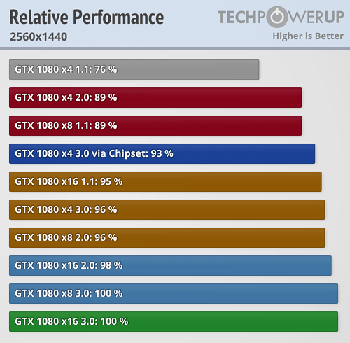

the PCIE x4 could be a problem for older PCs with PCIE 1.x or 2.x I guess
I was thinking about that too, but check out this review using the GTX 1080:
https://www.techpowerup.com/reviews/NVIDIA/GeForce_GTX_1080_PCI_Express_Scaling/24.html
Based on those results for 2560 Pascal cores (at 1607 Mhz/1733 Mhz), I think a card with 384 Pascal cores (at lower clocks) would only lose a few percent going from PCIe 3.0 x 4 to PCIe 1.0 x 4.
those tests are kind of limited yet x4 1.1 is clearly problematic, and I think it's possible that the 1030 only having 2GB of vram might suffer more with the limited pcie speed?
After factoring in clockspeed advantage GTX 1080 is at least 7x stronger in GPU core than GT 1030 so wouldn't GT 1030 at PCIe 1.0 x 4 would almost be like the GTX 1080 running at PCIe 2.0 x 16?
