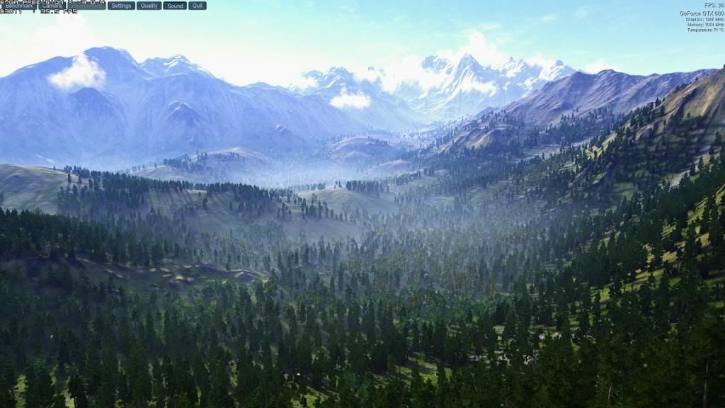

1334MHz at 86C?
1326779
Valley incorrectly reports GPU core clock. In keeps adding 100MHz to mine. Unless they fixed it, that Titan is likely 1234MHz. Still a very respectable o/c IMHO. Oh wait, I cant have opinions I'd only be lying to myself.
Not that I saw, sorry 🙁
All I can say from that screen is that it's under load, and it's fully heated up (end of run).

In this screenshot, Valley is reporting 1267MHz on my GTX660. According to eVGA Precision Tool, it's 1167MHz.
