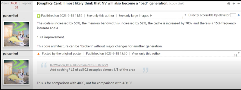

Well, XDA picked up the leaks from Chiphell Forum (it is in Chinese BTW, and I got the English version), basically confirmed the 512-bit memory bus that I calculated with more details:
  • +52% memory bandwidth: my figure is +50%,
  • +78% cache equal to 128MB L2 cache; pretty large area of cache even though N3E process won't scale much. With 512-bit memory controllers, that's mean each controller is connected to 16MB of L2 cache.
  • +50% scale most likely refer to CUDA cores which equal to 24,576 CUDA cores. XDA mentioned 192 SM total which might not be correct number cause nVidia going to change the structure of SM. Nonetheless the increase in CUDA cores align with memory bandwidth improvement.
  • +15% frequency increase: not much cause most advancement is on the amount of CUDA cores
  • 1.7X improvement: 70% improvement most likely refer to rasterization performance. RTX4090 has average of 45% relative performance improvement. If nVidia manages to pull it through, yeah Blackwell's performance upgrade will be bigger than Ada Lovelace.
I actually maintain a table of full range of RTX5000 series, and the most significant and bigger upgrade of Blackwell series is actually on 2nd and 3rd tier of GPU series. With flagship GB202 having 512-bit memory, GB203 most likely going to get 384-bit memory bus like RTX4090 and GB205 going to get 256-bit memory bus like RTX4080. The bandwidth improvement will be even bigger than GB202, thus I am expecting upcoming 5070Ti and 5080Ti will have at least +50% performance with much lower price points.
That's the part that's sketchy. With no scaling at all, that's a lot of very expensive real estate taken up by the L2. If this is even remotely accurate, it almost means that GB202 is near rectacle size. Again it seems like that's $3k+ Titan territory and not a 5090.
RTX 4090 vs RTX 3090TI
SM: +52% (128SM vs 84SM)
Base frequency: +43%(boost: +35.5%)
Raster performance 4K: +47%
RT performance 4K: +51%
Yet from Blackwell we should expect 70% higher performance from 72.5% more TFLOPs?
Looks to be about 30-40% from architecture and the rest from frequency, if that is accurate.
