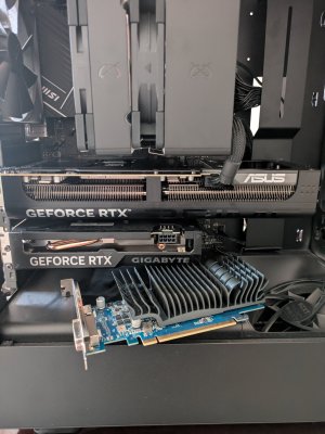

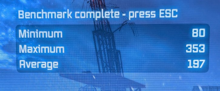

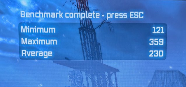

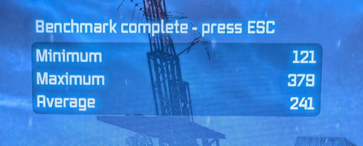

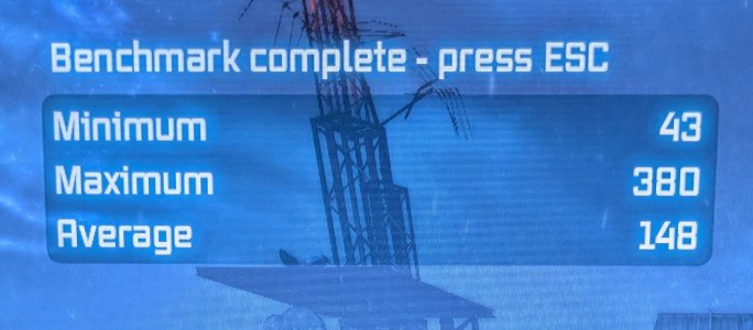

I happened to have some time this morning and was curious about PhysX performance with cards other than the 3050. Since I have a recently acquired 5070 Ti, I put a few configurations together and ran some Batman Arkham City benchmarks. I have a GT 1030, RTX 4060, 5070 Ti, and 4090 in the mix. The rig is the 9800X3D system in my signature.
PhysX set to high, VSync disabled, and 1440p resolution, but otherwise left everything at stock. Unfortunately I couldn't install a dedicated PhysX card with the 4090 due to its size. I ran each configuration twice to ensure results were within margin of error territory. My theory was that a 1030 GT would be sufficient to offload the PhysX, but clearly that wasn't the case. Also, I was very surprised to see the 5070 Ti + 4060 configuration beat my 4090 overall!

4090, no dedicated PhysX
5070 Ti, no dedicated PhysX
5070 Ti, GT 1030 dedicated PhysX
5070 Ti, RTX 4060 dedicated PhysX

Clearly even a 1030 helps a lot too vs. no dedicated PhysX card.

For real and I think one would notice a 43 FPS dip during a playthrough, where 80 FPS min is still silky smooth all the time.

Very interesting find, and it relates strongly with the choices made by the poster in that reddit thread: the GT 1030 was considered but ultimately RTX 3050 won as being the safer choice with more compute muscle. Turns out it was a better choice.
Yes, I'm convinced by my data that the GT 1030 doesn't have enough muscle for the task. I just happened to have it around and figured something was better than nothing, and it definitely was. It shows how much offload from the CPU it takes too. Batman Arkham City recommended a RX 460 for a dedicated PhysX card, and the RX 460 totally annihilates the GT 1030 in gaming, so the PhysX performance outcome is pretty expected in hindsight.
