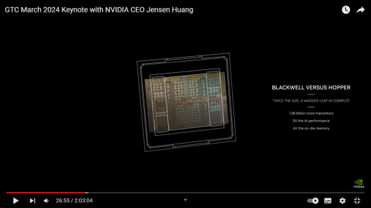

It's hard to tell from the keynote, but when Jensen was holding up the two it certainly didn't look like B100 was much larger if at all than H100. 30% higher average density than Hopper does seem in the realm of possibility if it's 104B transistors. I'm not photoshop expert, but just measuring the clearest die shot I could find from the keynote had the two die B100 complex as 51mmx33mm using the 11x11 HBM3 as a guide. If my crappy measurements were accurate, that'd be 123.7M/mm².
Hopper's not very dense though, it's 98.3M/mm² while AD102 is 125.4M.mm². B100 being 104B at the same die size as H100 would make it very slightly more dense than AD102. It might be more than a little hopeful to think 4NP GB202 will be +30% over 4N AD102.
It'd be interesting to know how they're counting transistors and the average density of the different areas, especially the new interchip interface. B100 only has 4 memory controllers vs 6 in H100 which might help there.
We need to pump the breaks hard on the whole +30% density line. This doesn't come from NV or TSMC, it's from a twitter leaker who claims it without any source or explanation of how he gets to that number. Most likely, he just did what you did here and compared a rough B100 density calculation to H100 but, as you mention AD102, is just as dense despite it being on the "old" 4N node. What is on the chip (how much cache, IO, memory controllers, libraries used, etc.) and how you count the transistors makes a huge difference in density calculations. NV is not getting a 30% density improvement from the process tweak. Even if they went from an N5 based node to an N4P based node with additional tweaks, you're looking at like 7% max.
