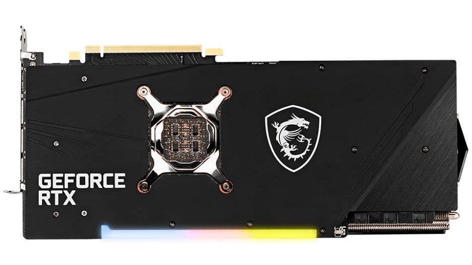

Yea, it sounds like the Founders Edition is the way to go... a fair amount of the AIB models got built slightly under power delivery/filtering spec requirements for the GPU; thus some ppl using boost clocks are experiencing issues.
The issue is likely related to the capacitors installed at the back of the GPU. In this generation (GeForce RTX 30), this is actually very easy to see as the most manufacturers did not cover this area with a backplate. There are six necessary bottom capacitors that are responsible for filtering NVVDD/MSVDD GPU voltages. The better the filtering the less likely the card is to encounter issues at high frequencies (ie factory-overclocking).
These cards will likely need a vBIOS flash that brings the boost clocks down. Either that or replacement PCB's, but don't hold your breath there.
Reactions: bigi
It looks like the Asus design was even better than FE, for the capacitors.

Yes, some of the AIB's cards spared no expense and their PCB has a full array of the better caps--meaning there will be less electrical noise and a more reliable power stream to the GPU (to support higher clocks).
I forget who said it but if you've got a setup, where the GPUboost conditions aren't met, then you're actually at less risk of crashing. Makes perfect sense. A lot of cards seem to teeter right on the edge of the stability threshold.

Well, to be fair most of the AIB's have made statements about possible issues in their design (or at least acknowledged claims), which is the right thing to do. Yes, they should have stayed on par with at least the reference spec provided by NVIDIA, but I feel like supply/demand for components may have played a role here. It was a bit comical to see multiple electronics engineers chime in with their .02; basically reiterate the point to death that the caps on some boards were going to cause issues. It's pretty concrete evidence at this point that that is where the crux of the problem lies.

New video from HWB. Long story short, according to their investigation the cap issue was a red herring and even 6 POScap board designs meet Nvidia's spec for non-oc cards. It came down to a driver issue and only in Windows, the Linux release driver never had any crashing issues and no updated Linux driver has been released. HWB tested the new driver and found margin of error decreases in clocks and power draw, the Linux driver has maintained the same boosting behavior since launch.
