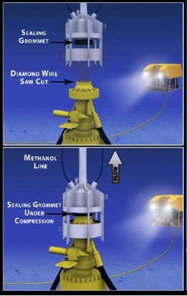

BP said preparations have been made for the possible deployment of the lower marine riser package (LMRP) cap containment system, which would be complex because of the depth of the oil leak.
Deployment would first involve removing the damaged riser from the top of the failed BOP to leave a cleanly-cut pipe at the top of the BOP's LMRP.
The cap, a containment device with a sealing grommet, will be connected to a riser from the Discoverer Enterprise drillship, 5,000 feet above on the surface, and placed over the LMRP with the intention of capturing most of the oil and gas flowing from the well.
Mr Suttles said it should capture "most of the oil" and was expected to last at least four days but "we cannot guarantee success at this time."
