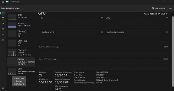

The problem is, the Device Manager, Speccy and a host of other programs, recognize the card. It has the RX 5700 XT listed above the iGPU in Device Manager. The drivers are also installed for the 5700 XT. But when I plug the HDMI into it, I get no display. When I plug the iGPU back in with HDMI, it displays fine. I have reseated the card, searched the BIOS for video card options ...PCI E etc and cannot find anything. The only thing I have not tried is updating the BIOS. But according to the revision, the BIOS installed is from late last year.
Device Manager shows the 5700 XT AND the iGPU, as does Speccy. Reseated the card and searched the BIOS. I dont see any graphics options in this BIOS. And I am in the Advanced part of it. Of course I havnt upgraded in over 10 years, so there is that.
I have looked for ways of disabling the iGPU, but most people say you do not need to. And of course, I could not find that option in the BIOS either.

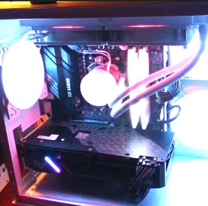

And when the card is powered on, there are two little white LED's on, right where the two power connectors connect to. Is that normal ?
Bear in mind that the last PC parts I purchased and built, was a FX 8120 / GTX 760 / 990FX board. So I am way out of date.
Again, card is detecting fine. just no display.

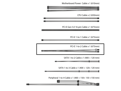

These are my Power Supply cables. The one in the box, is the one I am using. Is that the correct one ?
MB 24/20-pin x 1
CPU 4+4-pin x 2
PCI-E 16-pin x 1----------------------I am using this one. It has 2 x 6 pins + 2. The other end, has much smaller prongs.
PCI-E 8-pin x 3
SATA x 5
PERIPHERAL x 4

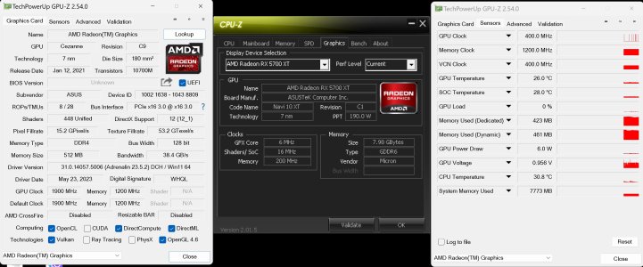

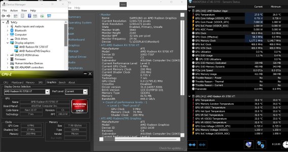

Here is a pic with different programs running showing the two GPU's. All of these were taken at the same time. Why is CPU-Z showing the 5700 XT, and GPU-Z showing the iGPU ? Task manager also shows both the GPU and the iGPU.

One thing you could try doing, is using 2 separate PSU cables to power the 5700XT. Also, what monitor are you connecting the HDMI to? If possible, you should try the other ports on the 5700XT, there should be 3 DPs I believe. It is possible that the HDMI port isn't working properly. But I also wonder if it isn't some issue with WIndows 11 trying to use the wrong display, or some firmware setting trying to force the APU graphics.
I actually just got done doing just that. Two seperate cables to the GPU. And I am trying to connect it to a 4K 55in Samsung TV. The 24" monitor I have, accepts DVI only....which is 10 years old now. I did order display port to DVI adapters, and a few HDMI adapters if id need them. Not here yet tho.
How is it, that these programs can pick up on two GPUs at the same time ? And shouldn't there be settings in the BIOS as well ?

Does it make a difference if the AMD Adrenaline software is telling me, GPU 1 is the 5600G, and GPU 2 is the 5700 XT, and both are using the same driver ?

Concerning drivers: Yes, it is normal for both the integrated Vega graphics and RDNA GPU to be listed, and they do indeed use the same drivers.
About the lights on the GPU: My Asus Strix GTX 1080 has the lights, and yes, that's normal.
