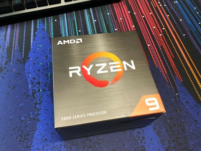

Info New 5950x box for DC ** Its live now ! See the bottom for details. **
biodoc
Dec 29, 2005
6,349
2,243
I can't believe it. The first day in 3 months that you can get a 5950x at Microcenter, or at B&H, and only ONE post on the entire forum (aside from mine) I thought people would be excited.

Well, I looked, and several microcenters did, online I saw it. Yours just didn't. But still, between B&H and the few microcenters that do, this has not happened in months. And ebay prices are dropping on 5950x's. Down to 1100, not that I would pay that, just an indicator of availability IMO.
