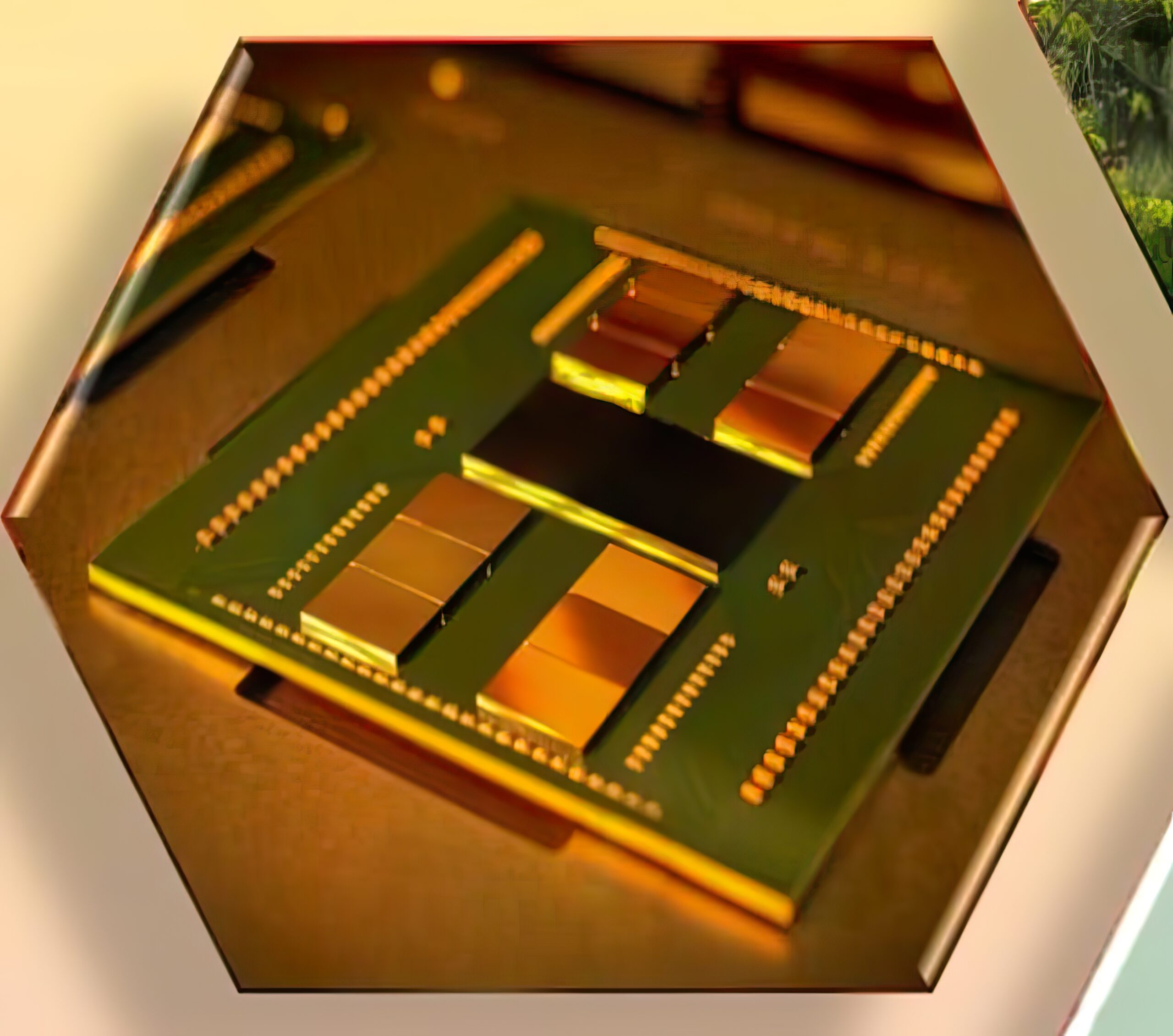

I don't know if this is an actual picture or if someone made a 3D render/print with known information, but it checks out in every aspect.
