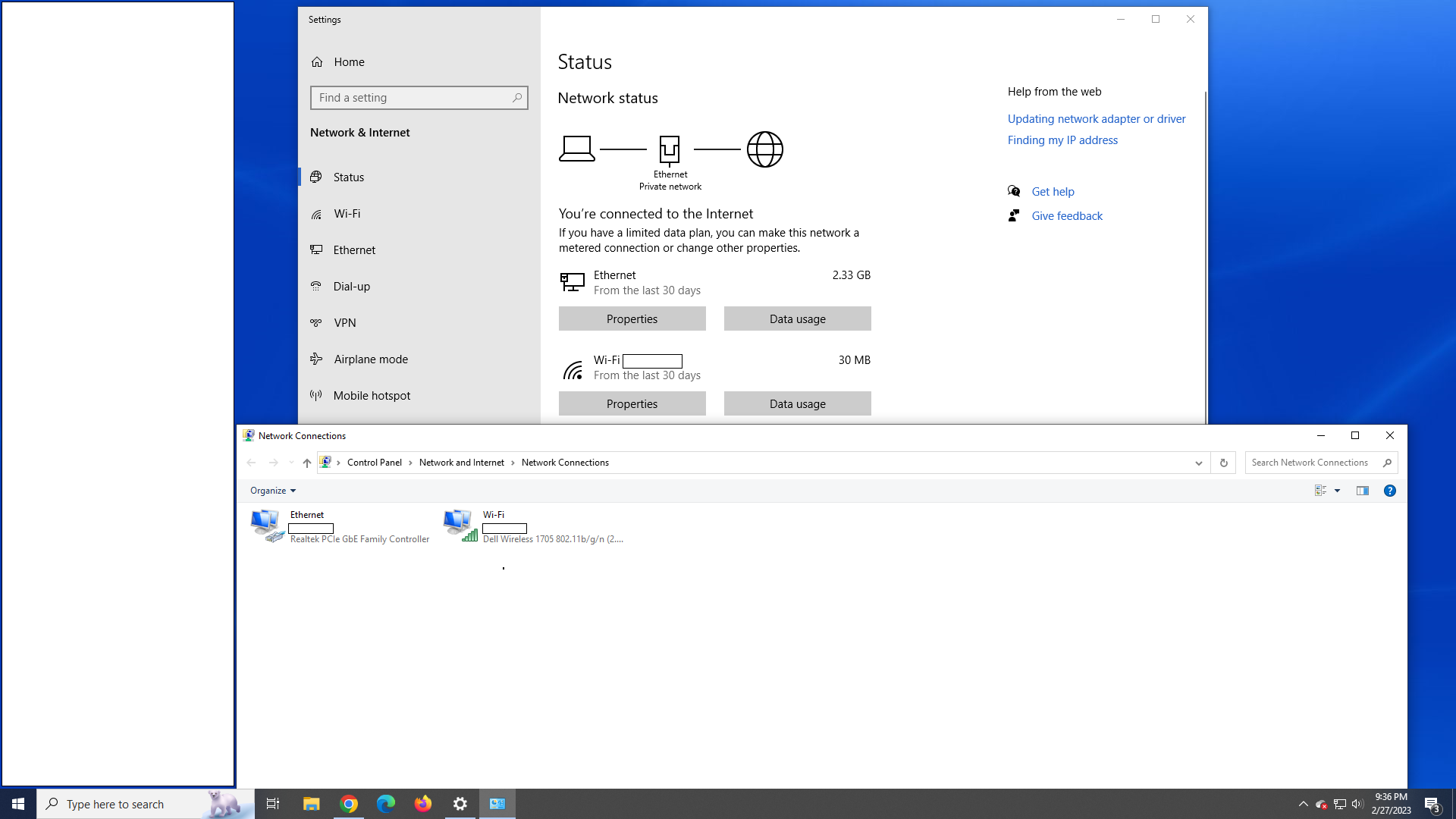

Can you post a screen shot of this.
Start -> type "View Network Connections"
The box that comes up should look something like this:dasf.JPG

well the thing that is confusing the hell out of me, or got me wondering is the fact windows says he has 11 network adapters.
Im wondering what the 11 adapters he has are.
The box that comes up should look something like this:View attachment 77303
Count em...that's 11...right? 1 and 1 is 11!
I scratched my head over that crap as well...
