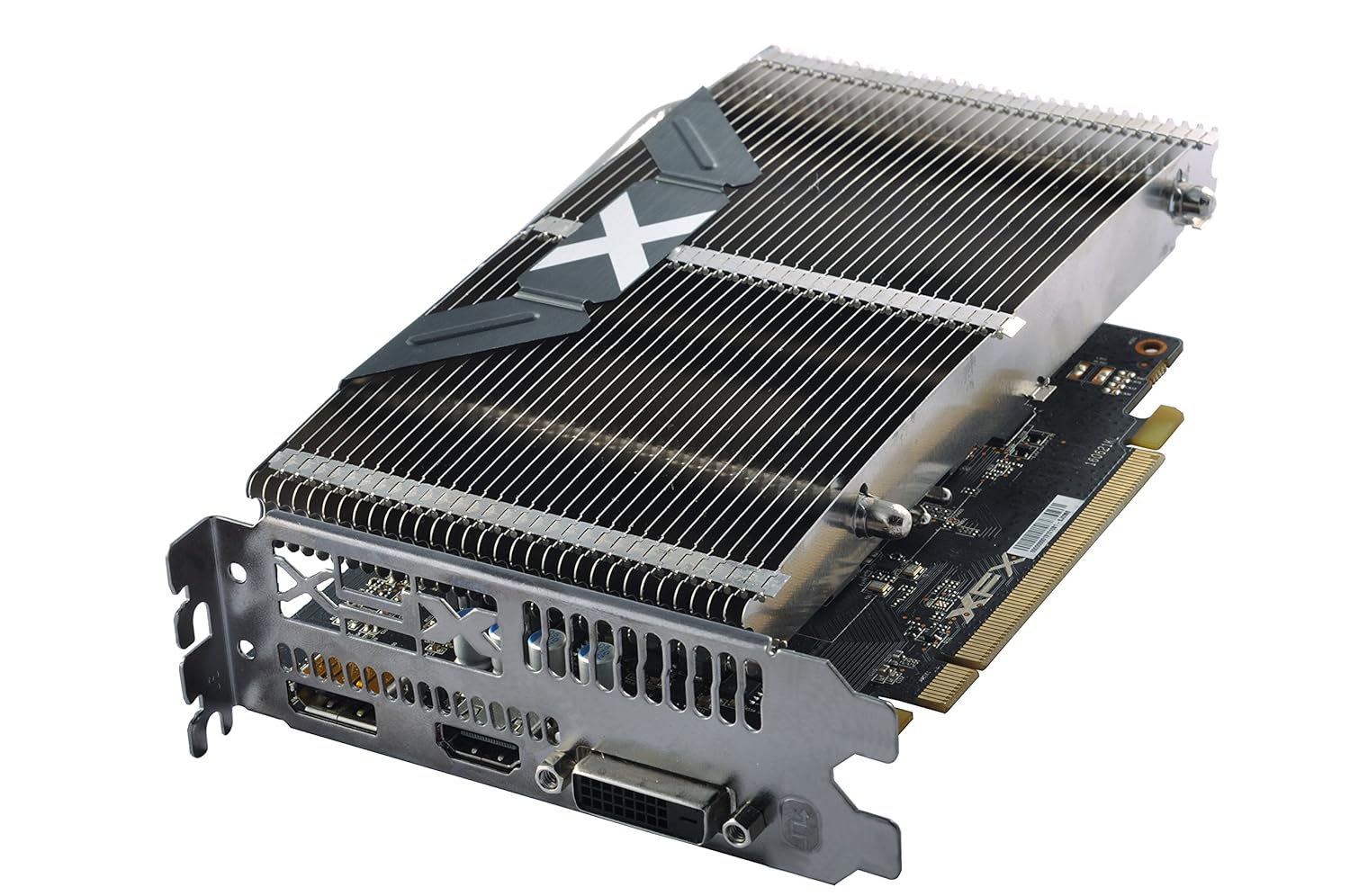

I mean, there's the RX 460 (of which, there is a single-slot variety), and the GTX 1050 and 1050 ti, each of which is available from MSI in a dual-slot, low-profile variety.
But where is the GTX 1040, in a single-slot, passive, low-profile-ready card, 25W, capable of 4K60 desktop display and video-decoding for all major current codecs? Where is it? Why is my only video-card choice around $30 for display-only the GT710?
Edit: And if NV makes one, will it support VGA at all? There's lots of lower-end rigs out there with VGA (only) monitors, that could use an upgrade, for video codec support, to keep their PCs relevant in the "Rich Media Age" of pervasive online video. Think of all of the Core2 rigs out there, some using GMA3100/4500.
I don't think that card exists. As you already mentioned, the lowest dGPU available today is the GTX 1050. AT previewed the Gigabyte GTX 1050 low profile here. It would be cool if you could just use an iGPU to do it all. I believe that modern Intel CPUs can do H265 (Haswell and newer), but it would be noisy I think.

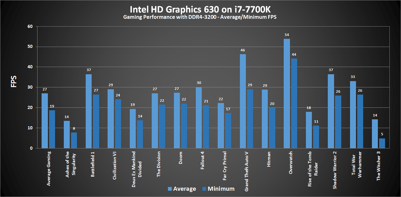

Kaby Lake IGP perf isn't superb, but on less demanding titles it's quite capable. Below are many modern, demanding titles, and many of them it's hitting 30FPS average (albeit without enough information concerning resolution, settings, etc). Some (Overwatch, many more titles in the last 2-3 years) it's fluttering around 60FPS avg, if not minimum; moreso if you're running at a lower resolution (which you may be, if you're working from a tablet/ultrabook). This isn't nearly as far away as you might think from an RX460. This will improve as the iGPU tech improves, and as I'm sure anyone will agree, iGPU will become the minimum that discrete cards will have beat if there's any value proposition in them.
There's still a market for 'light gaming', it's just not in the discrete cards, because the iGPU is eating away at that.
The Intel Sandy Bridge iGPU isn't supported in WIndows 10 and the Ivy Bridge iGPU (as found in the locked Core i5 and below) is only 6 EUs.
[DHT]Osiris
Dec 15, 2015
17,455
16,774
Huh? I was referencing the more recent offerings, such as the Kaby Lake series (or the iris pro series). Yeah, the older ones were terrible, and the newer ones are better. Future ones will be better than these, and creep closer to the low-end DGPUs. That's all I was saying.
