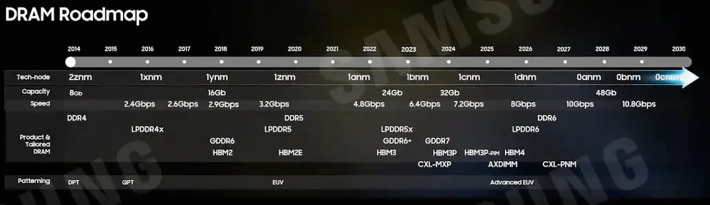

Info LPDDR6 @ Q3-2025: Mother of All CPU Upgrades
BOMBSHELL NEWS:
"Industry-leading features come with 25% higher performance, 30% more capacity and 25% higher power efficiency
Samsung’s 10.7Gbps LPDDR5X not only improves performance by more than 25% and capacity by more than 30%, compared to the previous generation, but also expands the single package capacity of mobile DRAM up to 32-gigabytes (GB),"
Looks like LPDDR6 will have to wait.
I wonder if SK Hynix and Micron will announce their own counterparts to Samsung's LPDDR5X-10700?
When Micron and SK Hynix announced LPDDR5T-9600 and LPDDR5X-9600 respectively, it appeared as if Samsung had fallen behind as their highest speed offering at the time was LPDDR5X-8533.
There were some rumours that Samsung was preparing an 'LPDDR5W' with 9600 Mbps speed to match Micron and Sk Hynix.
But now, with this official announcement, Samsung has absolutely knocked it out of the park with a whopping 10.7 Gbps speed. Now it seems like Micron and SK Hynix have been caught off guard.
The fact that Samsung has announced LPDDR5X-10700, makes me certain we will not seen LPDDR6 supported by the next generation smartphone SoCs (Snapdragon 8 Gen 4, Dimensity 9400).
Think about it, JEDEC hasn't even ratified an LPDDR6 standard yet!

Samsung announced LPDDR5X-8533 in 2021 November. About 15 months later, in 2023 February, they had phones shipping with it (S23 series).
Samsung has officially stated LPDDR5X-10700 mass production starts in 2024H2. They haven't given a shipping date though.
If S25 series utilises LPDDR5X-10700, it will be shipping ~9 months after announcement.
If S26 series utilise LPDDR5X-10700, it will be shipping ~21 months after announcement.
I wonder where Samsung's LPDDR5X-10700 announcement fits into this timeline
If LPDDR6 is coming to market in 2026, then LPDDR5X-10700 has to come to market before that, or it doesn't make sense.
Not necessarily if (and I don't know if it is true) their LPDDR5X is fully compatible with LPDDR5X-8533 then it would be a drop in upgrade for existing designs with 5X controllers. A lot of companies (hi Apple) are going to be risk averse about adopting LPDDR6 because they need to be certain sufficient supply is available at their desired price point (relative to 5/5X) when their designs hit the street.
So they need to make the decision about what controller to use at least 18 months before that. Or longer, if LPDDR6 controllers are larger, because they can't make major floorplan changes too close to tapeout.
