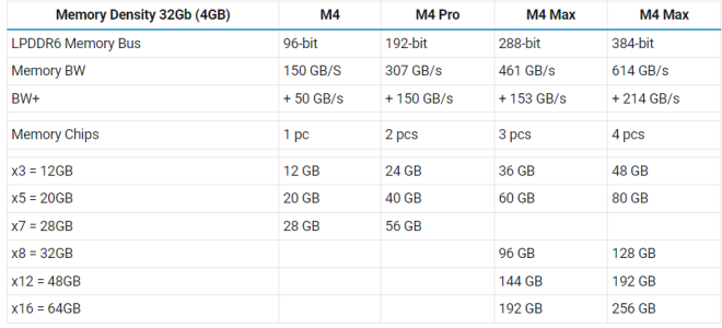

M4 Series with LPDDR6: Biggest Memory Upgrade
Gurman mentioned upcoming M4 series going to support up to 512GB. As shown in the table below, Apple going to use highest memory density (32Gb - 4GB) in order to support 256GB in upcoming M4 Max. The memory has to be LPDDR6 that build by EUV machine. M4 Max has doubled the memory size compared to M3 Max which support up to 128GB LPDDR5. It is considered biggest memory size upgrade cause the next upgrade will only happen in 2029 if my prediction is correct...
The M4 chips will be built on the same 3-nanometer process as the M3 chips, but Apple supplier TSMC will likely use an improved version of the 3nm process for boosts in performance and power efficiency.
@Doug S @FlameTail You two seems missing what Gurman wrote about M4 series going to be built by same 3-nanometer as M3 chips. Clearly it means N3B process which I have been saying for years. And you two also keep mentioned that M4 going to be build by N3E process. Or do you still think so? Do you want to wait until M4 launching then realize the mistake or admit now?
M-Max SeriesDateMax MemoryM-Ultra Max Memory
M1 MaxQ4 202164GB 512-bit LPDDR5128GB 1024-bit LPDDR5
M2 MaxQ1 202396GB 512-bit LPDDR5192GB 1024-bit LPDDR5
M3 MaxQ4 2023128GB 512-bit LPDDR5NA
M4 MaxQ4 2024 ?256GB 384-bit LPDDR6512GB 768-bit LPDDR6
2029384GB 384-bit LPDDR6768GB 768-bit LPDDR6
