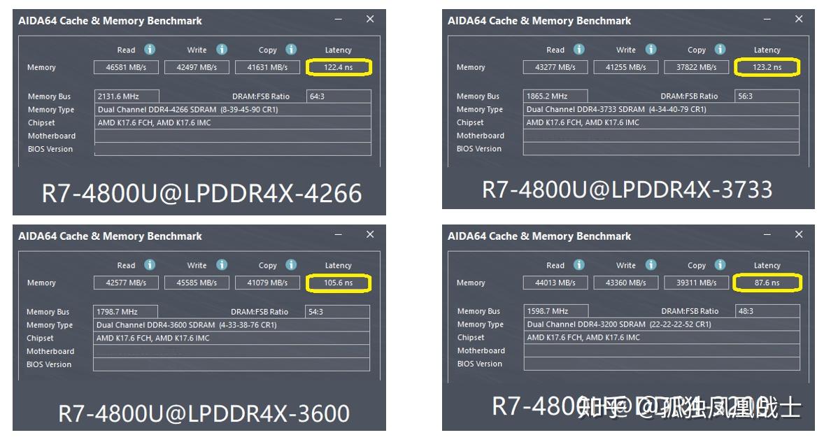

Here, referenced by no other than @chiakokhua:
There's a very detailed analysis of mem-speed and FCLK there, which is quite readable with Google translate (lots of AIDA64 pictures at source too):
Besides it should be expected that zen2 runs like zen2 not some magical fairy dust just because it's on a single Die
It's worth remembering that monolithic dies still use IF to hook up the CCXes to memory controllers etc (if you can find the diagrams these links are called CCMs). As such FCLK is still a thing, however with Zen and Zen+ it's just tied to MCLK (or was it UCLK, I forget now), so the end user never knew it could be adjusted seperately like you can with Zen 2. FCLK has always been the limiting factor in getting higher memory speeds with Zen, it's a bit of a shame that AMD didn't improve it further with Renoir to try and get LPDDR4X-4266 running in full 1:1 mode though, even if only when the la0top was plugged in.

I still cannot figure out why you are talking about IF when memory controllers are decoupled from IF in Renoir.
And from the Chinese review, the LPDDR4X seems to be running at 4266 (2133MHz)
Also, I cannot see which laptop/s they used in the Chinese review.
Reactions: mtcn77

There was a mention of IF max clock. 2400 it was. Looking in the same mindframe with 1.6:1 ratio, it enables 7200MHz ddr(double data rate). Btw, 3200/1066 equates 1.5, sorry about that.
mtcn77
Feb 25, 2017
105
22
Woot, I'm most wrongly assuming too much;
It uses a low-power double-data rate four x(LPDDR4X) interface for 4266 MHz.
Fabric clock in Renoir is probably forced to asymmetrical 2:1, rather than 1:1.
.dram_speed_mts = 1600.0 => .fabricclk_mhz = 600.0 // DRAM @ 1600 MHz = IF @ 600 MHz
^-- probably a weird idle.
.dram_speed_mts = 2133.0 => .fabricclk_mhz = 1066.0 // DRAM @ 2133 MHz = IF @ 1066 MHz
.dram_speed_mts = 4266.0 => .fabricclk_mhz = 1600.0 // DRAM @ 4266 MHz = IF @ 1600 MHz
^-- If it was 3200 MHz, fabric clock would probably be also 1600 MHz.
Good guy, Seronx.
Just wondering, have you ever given this a read?
AtenRa
Feb 2, 2009
14,003
3,362
What im saying is that the IF frequency and the Memory Frequency in Renoir are decoupled, so how is the memory bandwidth related to IF frequency ???
uzzi38
Oct 16, 2019
2,746
6,655
Yeah, you should probably read the article.
CCXes are connected to the memory controller via the Infinity Fabric. If your IF is running at 1600mhz, then your CCXes are receiving data at the same rate.

4800U doesnt scale up at 25W TDP because this Laptop uses DDR-4 3200 (51.2GB/s) and not LPDDR-4X 4266 (68.3GB/s)
I asked the autor of that review for average clockspeed of IGP and he replied to my comment this, you can find It in the original review.
The measurements on page 14 were done during 10 runs of Cinebench R15.
During gaming, the average clock speed of the IGP was 1140MHz for 15W and 25W, and 950MHz for 12.5W. The peak was the same every time – 1750MHz
The biggest problem is not using DDR4 instead of LPPDRR4, but the identical average clockspeed for both TDPs! The only question is why the higher TDP didn't increase the average clockspeed of IGP and It stayed at 65% of max turbo clockspeed.
