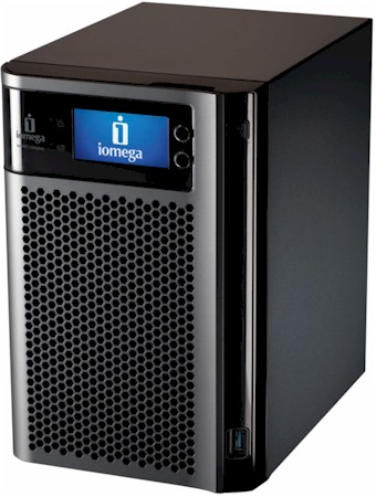

Interesting discovery among my two PX6-300D's.. Both were brand spanking new, in new retail box..both running same firmware, etc..
The second one I received is idling around 48C.. the first one is around 20C higher. (only difference is it has 6, 3.5 inch 2TB drives in it.. versus the one that runs cooler has four 2TB drives + 2 small 256gb SSD's).
Maybe I should pull the fan/heatsink and possible re-paste these.. considering they are new, old stock that have been sitting and might have dried up thermal paste?
Tjunction spec on the D525 CPU is 100C... assuming both of my NAS's are well within safe range .. just thought this was odd on the 20C difference with same two boxes :)
