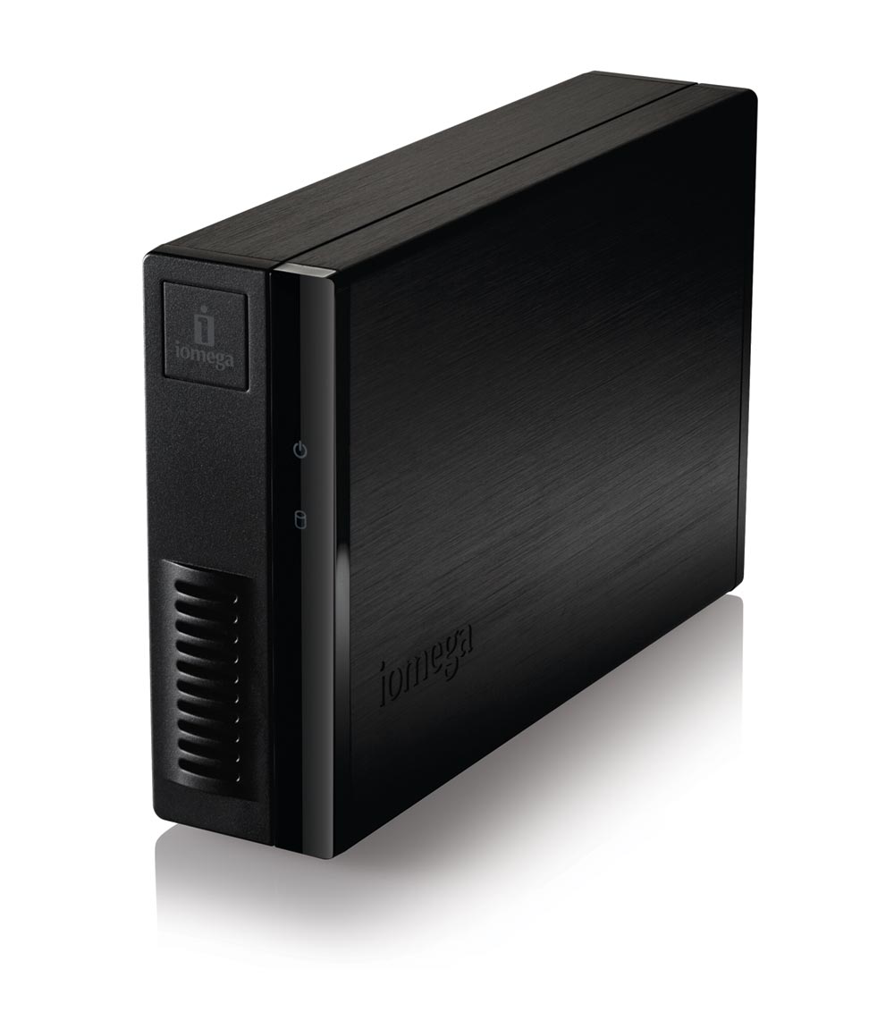

For $25 I may pick up one of the 1TB media servers, essentially looks like a one drive NAS. https://www.parallelminer.com/produ...ter-1tb-2tb-3tb-network-attached-storage-nas/

So, I just saw that there is a fanless, 1 drive version of this with 3TB available for $65 at centrix and $48 at parallel miner:

The EZmedia single drives are so cheap I was tempted, but iirc after some searching on them decided to skip them.
Re the IX2, iirc there is an option in the settings to disable fan control so it defaults to full speed. Both of my IX2, new and 5 years old tend to run hot ala 140ish F in our 73F house, one of the reasons I only bought one more of them and am still looking at a PX4-400D, two years newer product and pro series instead of consumer.
If only 3TB wasn't such a lame size for future expansion, and the EZmedia the only system where they seem to be pricing the drives attractively.
My gut feeling is that they are dinking around with the pricing, mostly raising some prices in preparation for some big sale to actually move a few of the 131 for example PX4 they still have not sold. Sunday night, Monday morning is my usual check prices day, as soon or if a 4x 4TB option gets tempting I may get one more NAS
What did you find on the ez media? From what I can tell it uses the same firmware as the ix2?

I did a little searching in my docs, found zip, so it may be located in the device setup using the web interface of the IX2. Hover the mouse over items and a pop up shows the options.
Nominally I was looking for a 1TB ext to use with my Wii, so it could have been something USB related, but it nixed the device at $25 shipped, so could have been something basic.

I can tell you I am using 4x Hitachi 8TB drives in my PX4-400D
Reactions: SamirD

Someone in this thread reported success, with "maybe" a touch of fussing using 8TB drives. I'm looking at 4x refurb HGST 4TB drives off ebay.
Shipping was free, calif tax about $10, total was $119.36.
8TB worked fine in my ix2 straight out of the box so I don't think you'll have any issues. I actually have a 16TB I'm going to try in my ix2, the ezdrive, my old netgear readynas (it already works with a 12tb), and my synology, and a new to me qnap on the way. This should keep me good on storage for a while. :eek:

So a little bit of an update on my ezdrive. Definitely not the fastest thing--tops our around 22MB/sec, which is basically usb speeds. But for the size of an external usb drive except the convenience of a nas, it works for me. Great off-site backup device that doesn't need a computer to get to the files.
But the problem with the one I got (and perhaps with all of these) is that the drive used was the notorious ST3000DM001--the famed drive in the backblaze reports that had high failure rates:
So while the nas was working fine and passed a h2testw write test (it didn't do the verify for some reason), after copying a little over 2TB of data, the nas became terribly unresponsive and transfer rates dropped to just a few MB/s with a lot of choppiness.
Well, I emailed parallel miner and got a quick response. I mentioned that I suspect the drive has failed versus the unit so I can test the drive if that helps. They said go ahead so I disassembled the unit and tested the drive using WD's datalifeguard. The drive passed the short test, but failed a long test citing 'too many bad sectors'. So the nas unit works well with speed caveats, but the drive may fail on you. Parallel Miner is sending me a replacement unit. They even offered an upgrade to an ix2-dl unit, but since their current stock of ix2-dl's are actually regular units sans drive, you have to install the firmware on them so I passed on the deal.
Since I just recently got some 16TB Seagate Exos drives (which are running a long scan in datalifeguard), I plan on putting one of these in the ezdrive and see what happens.
If I can get the fan to run faster in the ix2 I have, I'll try 2x 16tb in it too. I have every confidence it will work in the ix2 and am quite curious about the ezdrive.
That would make my stockpile of ix2-dl units a bit more valuable, if they can actually take 2x 16TB drives. Are you going to RAID-1 (mirror) them (16TB net), or RAID-0 (stripe) them (32TB net)?
SamirD
Jun 12, 2019
1,489
276
www.huntsvillecarscene.com
I can try it both ways as I just plan to install them and then probably use them jbod if that's possible.
But again, I've got to find a way to cool that thing before I even think about 2x drives. It's too hot for my tastes as it is right now and I can't find a way to get the fan to run 100%.
