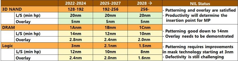

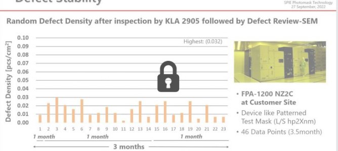

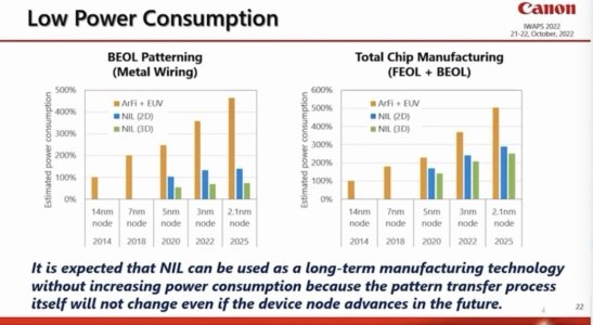

I thought NIL had major issues with defect rates in any kind of production quantity throughput. Have those issues been solved? Is anyone using NIL in production today?
Defect density is currently low enough to do logic starts for older nodes.
hp2xnm ~ 40~60nm metal pitch
This is good enough to start, 0.01 is needed for HVM w/ end process D0 being 0.3 less like TSMC Risk production.
3nm/2.1/1.5 hasn't been validated for defect density yet, which is the end target not the start target//
The above is heavily pushing for 3nm (12nm hp etaby:2024) ~ 1.5nm (8nm hp etaby:2028-onwards)
Older nodes are good enough with larger than 20nm half-pitch being near 0.01. Of which, the same tool can be used for much later nodes.
12FDX HP-193i = metal1-metal4 is 56-nm pitch
12FDX HP-NIL = metal1-metal9 is 56-nm pitch
9FDX NIL = metal1-metal9 is 48-nm pitch
6FDX NIL = metal1-metal9 is 40-nm pitch
potental plus node here for 32 and 36-nm pitch from 6FDX
3FDX NIL(not 3nm logic node, but rather 5nm logic node) = metal1-metal9 is 28-nm pitch. // Adding ULK pores and insulation is very achievable with NIL.
The tool for HVM won't start full production till 2025 (Canon Japan[for china/japan] and Canon Texas[for america/europe]). NZ2C != HVM tool, so it isn't being used in anything that leads to products.
NZ2C maxed out is >200 wph, and average max speed is ~160wph.
The next tool skips over the NZ3C(6-cluster machine) goes for a 8-cluster machine, with a maxed out capacity of >400 wph, average max speed of ~320wph.
