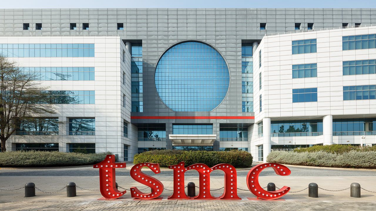

This isn’t engineers this is skilled craftsman. Here is a quote from ASML on installation of EUV.
Peter Wennink
Good question. We need to realize it. If you look at the reasons, predominantly the push-out had to do with fab readiness and that was basically driven by construction skills. And you think, "Well, how can that be?" You just hire a couple of construction workers and you just build the fab. Well, just building a $20 billion fab that's going to do a 5- or a 3- or a 2-nanometer product is a skill and people don't seem to realize that when we start building, those fabs across the globe now and are everywhere, that skill has been refined over the last couple of decades in only a few places on the planet, and predominantly in Taiwan and in Korea and a bit in China.
Now having to do that now and accelerate this will lead to all kinds of issues, because we are still building those fabs in Korea and in Taiwan, but also in other places on the planet, also in the U.S., for instance. And so, getting access to the requisite skills and skilled workers to keep the construction plan on time is a challenge, as at least what customers tell us, and this is the main reason. So, you can easily look at a delay of a couple of months or a quarter.
> 'These workers have been building fabs for Intel for decades,' the head of union claims
Frankly, TSMC is cheat, is'nt it?
In addition, I find TSMC plotting for fleeing from the environmental impact assessment in Kumamoto, Japan.

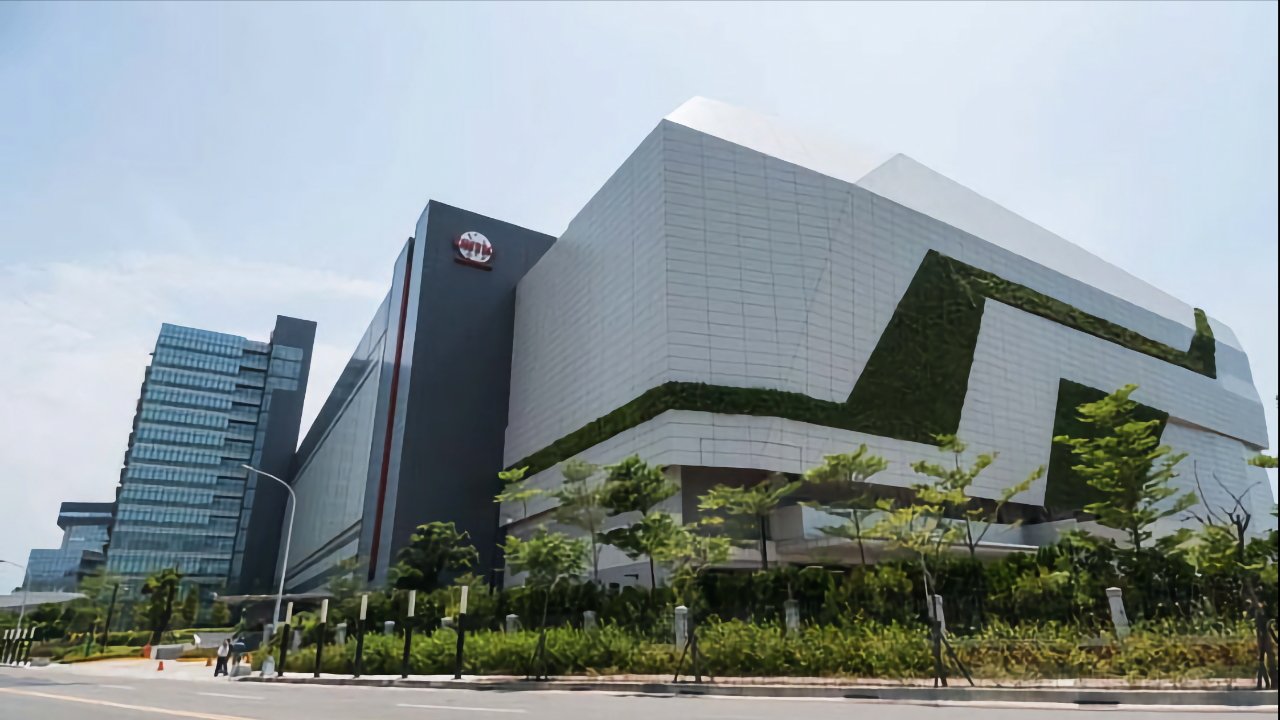

Arizona union destroys the cheat of TSMC.
> Smith’s one specific claim is that American workers can’t install lithography machines.
> In fact, union pipefitters are already installing lithography machines at TSMC, as well as nearby Intel.
> (The equipment is not specific to TSMC. Both use equipment from the same Dutch vendor: ASML.) Workers have their own thoughts on technical details of the job—on which, more below.
> The broader point is that, with all the concern about how Americans have lost their dynamism and mojo, there’s a risk of mystifying the task at hand.
> “What pipefitters, electricians, and others do is hook up equipment,” Aaron Butler, president of the Pipefitters’ local and head of the Arizona Building Trades Council, told me.
> “The pipe does not care what it’s going to. My guys don’t make the chips, they’re not trying to run the lithography equipment.
> We connect the piping to the mechanical connection, pressure-test the line, make sure it’s clean and quality, and walk away.”
> Ironically, TSMC may be crushing the opportunity for learning-by-doing to emerge in the construction stage of the fab.
> TSMC has outsourced most of the job site—like its janitorial work—to temp contractors with little training and high churn.
> Even where it has brought in union workers with a career in the building trades, it has done so grudgingly and kept them on precariously, disincentivizing investment in training and growth.
> The company, in other words, has opted to work wherever possible with the least-skilled segment of the American workforce.
> Now, as it turns around to bring in its own skilled workers, would-be supporters of industrial policy are declaring that this was inevitable.
> IN THE CASES WHERE TSMC HAS USED UNION WORKERS, workers in the building trades have plenty of notes on how they’re doing the job.
> Luke Kasper of the sheet metal workers union, for example, worries about the quality of the Teflon-coated stainless steel ductwork.
> Where non-union contractors have done the work, he says, gaskets are missing in areas, and not all of the ductwork achieves an airtight seal.
> “Even though it’s negative-pressure exhaust ductwork, it’s not supposed to be done like that,” he said. Corrosive exhaust passing through the ductwork could leak.
> Butler, with the Pipefitters, described ongoing disagreements over welding techniques. Polyvinylidene fluoride (PVDF) pipes are the arteries of a fab, carrying pure, ultraviolet-treated water to the clean room.
> Arizona Local 469 pipefitters have been installing mechanical piping in clean rooms since Motorola production sites sprung up in the 1980s, and many members learned to weld the PVDF by hand, using socket welding, which requires a paddle.
> Butler says socket welding can be leaky, and he favors the Bead and Crevice Free (BCF) process, which is automated and produces data on quality.
> But TSMC favors socket welding, so they have continued to use the older technique.

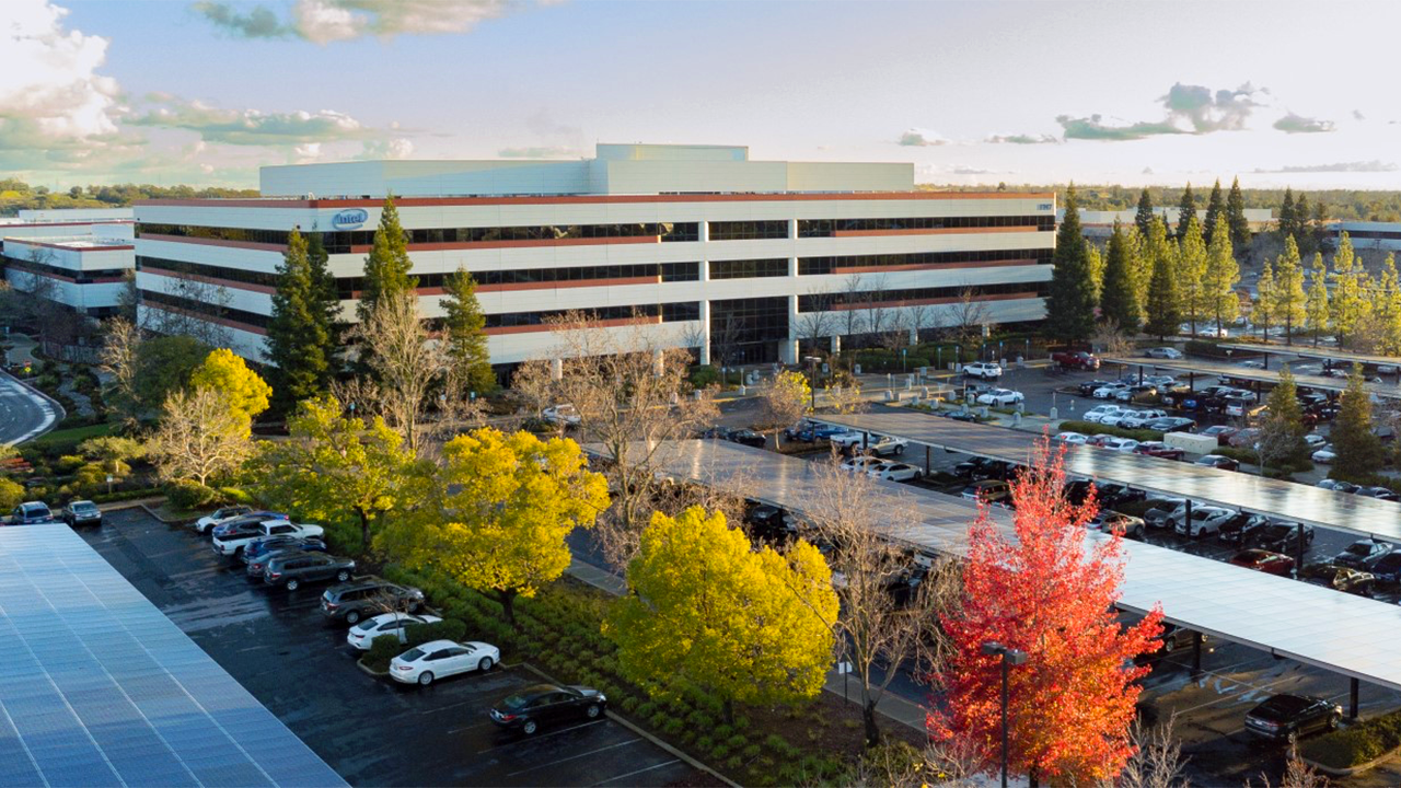

Looks like the Intel/Tower Semi deal is dead.
Intel was forced to modify their strategy...
What does Intel do next ?
Is it tried similar and smaller M&A which doesn’t need regulatory approval ?

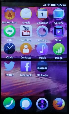

Speculation: Snapdragon 2/2c;
1x P670 cores
3x P470 cores
Adreno iGPU
With KaiOS 4.0(Firefox OS (Firefox version 94+ supports RISC-V => FirefoxOS supports RISC-V)) touchscreen-based phones returning from the pits of hell:
