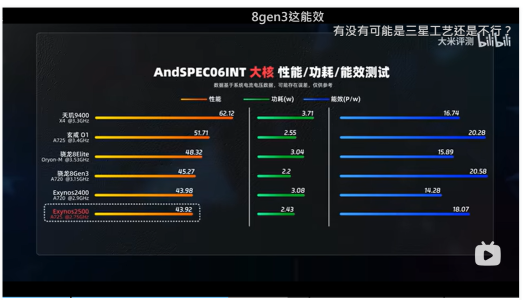

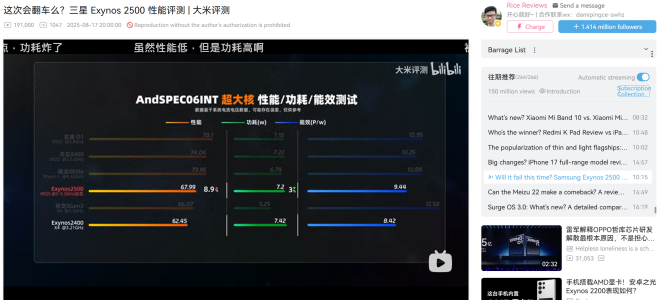

So after searching for a bit I did manage to find some power data for the Exynos 2500. Unfortunately Geekerwan has not yet covered it yet, but...
10% perf/watt difference at Fmax vs the 9400, ~15% vs the Xring. This sounds much better than it is, IMO, since perf/watt gaps usually are smaller at the rightmost part of the curve than the middle/low end. Could be much higher in that region.
Meanwhile, for the Medium cores:
Similar 10-15% perf/watt difference.

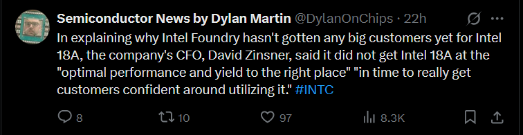

* First wave of 18A missed- performance and yield were not ready in time.
* Still opportunity to get customers for 18A - multiple waves of demand- time and effort to get there.
