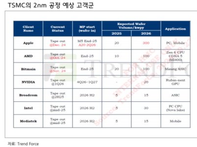

However, it is a little questionable that AMD's N2 demand forecast is less than Intel's N2 demand forecast.
Well, 14A is a generation ahead of TSMC A16, so let's see how it goes.

Because Intel still does have a huge volume advantage especially in client, and it's also their second year of N2 according to the graph, while it's AMD's first.

Likely wrong tbh they don't need this much considering it's just 8+16/8+16 bLLC and NVL Halo iGPU iirc.
AMD and Intel must have swapped that would seem correct.
There was this leak as well
If you look, the AMD graph on the earlier slide is about 10k wpm in 2026... so that does match.
As for Intel, maybe they've expanded the scope to other dies. Which is crazy given the cost structure but maybe it's cheaper than spending $40B on 14A?
511
Jul 12, 2024
5,302
4,721
This is WPY divide it by 12
AMD ~8.3k wafer/month
Intel ~2.5K wafer/month
If you swap both than both numbers makes sense
Whoever is spreading this rumor is false they can't magically increase scope of types of die 1 year prior to launch if it was 2-3 years ago it would have made sense but now.
